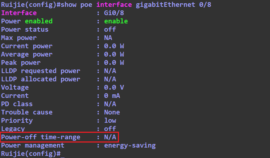

1) Run the show poe interface gigabit Ethernet  0/8 command to view the configurations and the power supply information
Power-off time-range is N/A

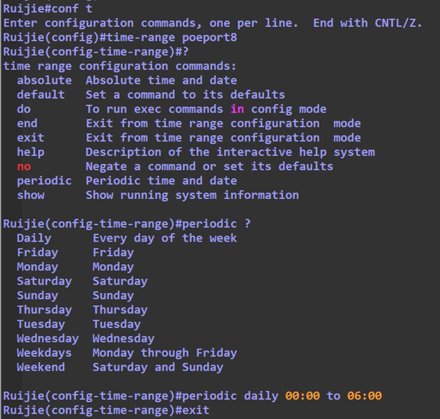

2) Configure time-range of the PoE.

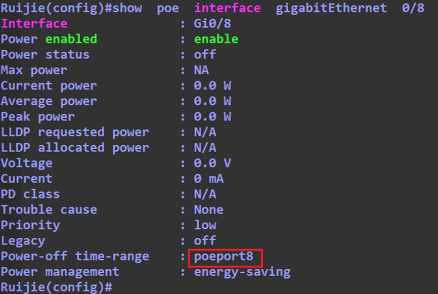

3) Associate the port time-range configuration for the port 8
4) Run the show poe interface gigabitEthernet  0/8 command to view the configurations and the power supply information.

Ruijie#conf t
Ruijie(config)#time-range poeport8
Ruijie(config-time-range)#periodic daily 00:00 to06:00
Ruijie(config-time-range)#exit

Ruijie(config-if-GigabitEthernet 0/8)#poe power-offtime-range poeport8
Ruijie(config-if-GigabitEthernet 0/8)#exit
Ruijie(config)#show poe  interface  gigabitEthernet  0/8
