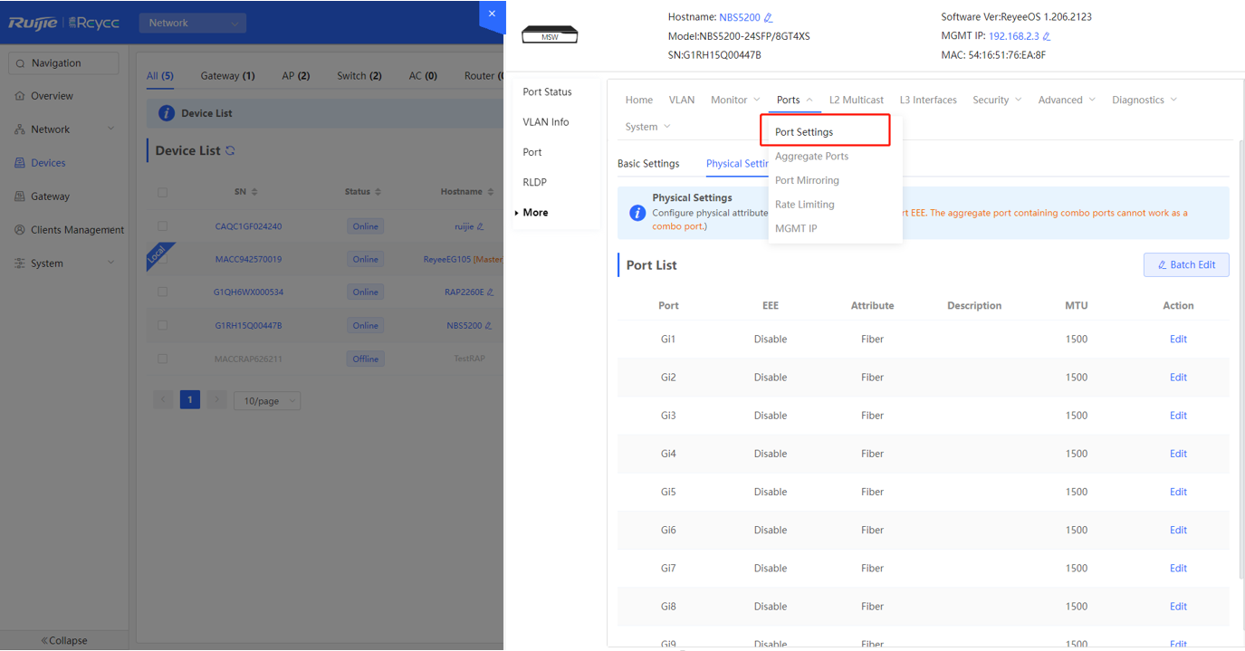

1.Click "Port settings"

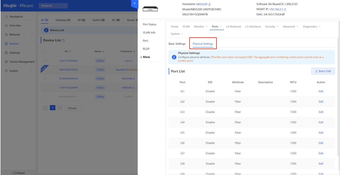

2. Click "Physical Settings"

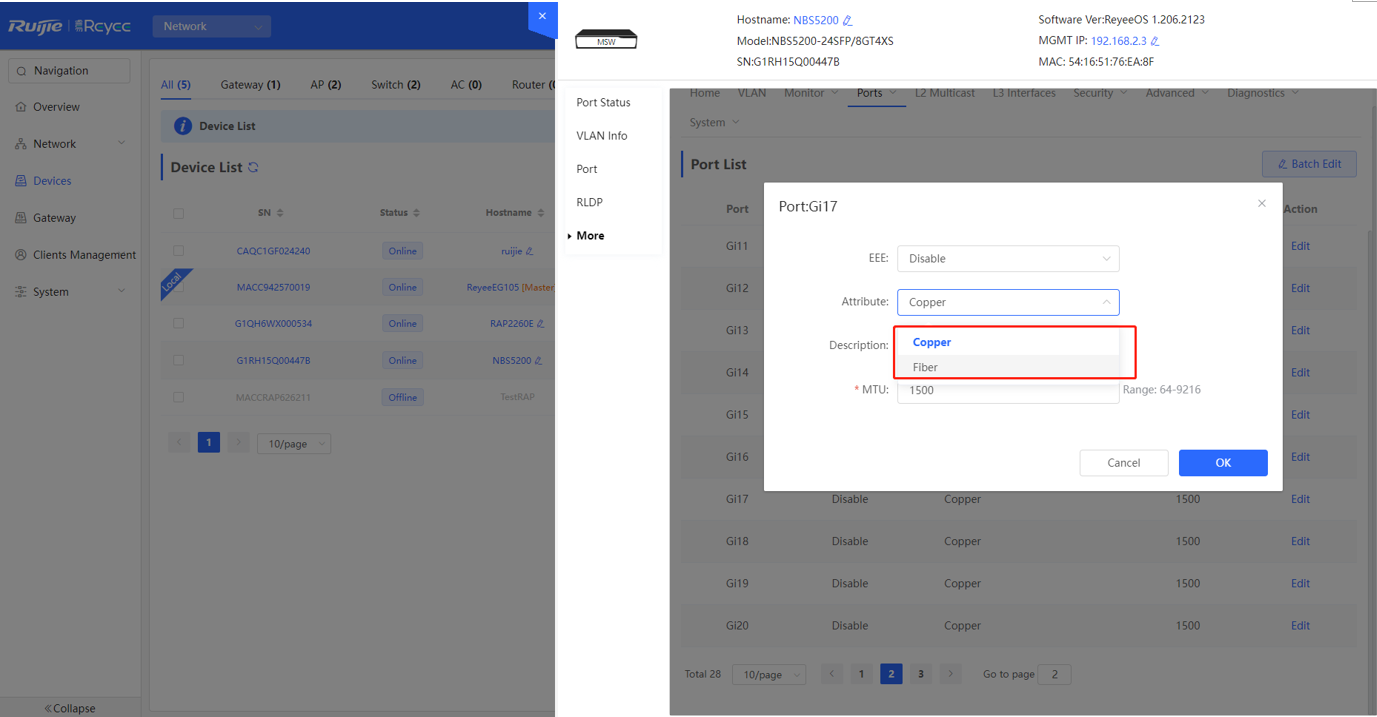

3.Select the interface number of the photo electric multiplexing, change the physical type of the port in "Attribute"
