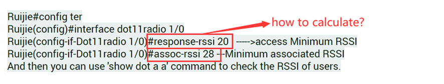

How do I calculate rssi (received signal strength)? Reply
4398 0 2022-12-13 17:50:17
RSSI refers to the received signal strength, ranging from 0 to 100
The corresponding wireless user signal strength is-95 on this basis, for example, if you configure it to 25, the correspondingwireless user signal strength is 25-95 = -70dBm. So if you want to set it as -75dBm, you shouldconfigure:
Ruijie(config-if-Dot11radio 1/0)#response-rssi 20
RG-AP180(JA)
Configuration Wireless
