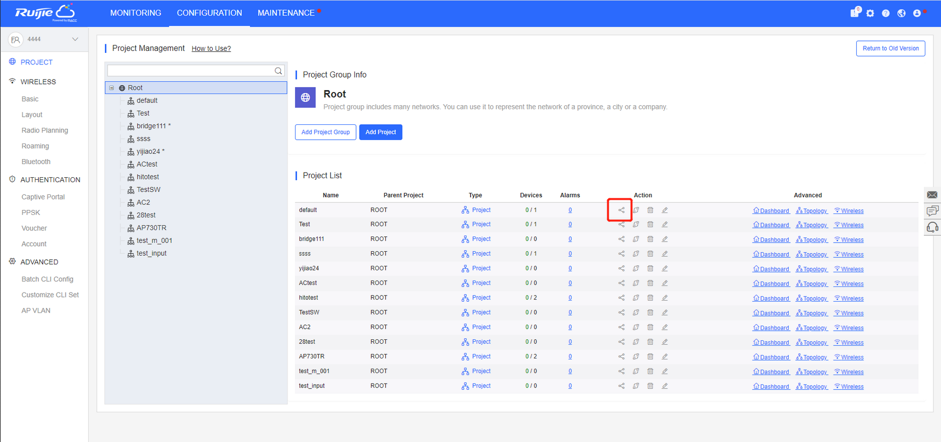

If your network doesn't have such device, but the network topology still display wrongly, please try to refresh it and check again, if problem still not solved, please help share me your network to further check:
