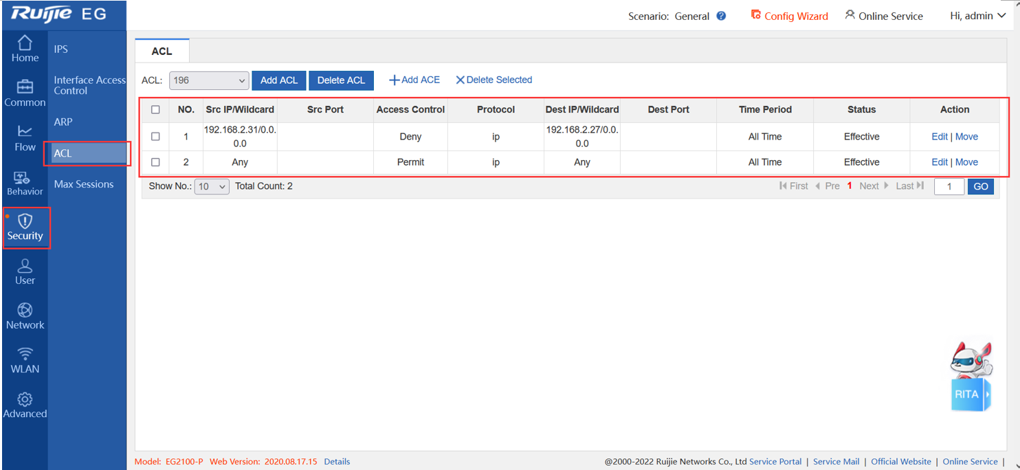

Step1: Please check whether the traffic matched the ACL rule which you have set here:

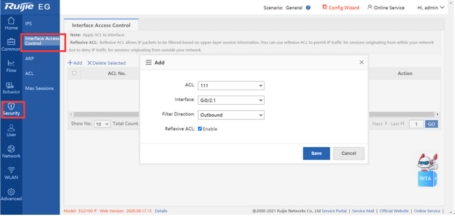

Step2: The ACL rule has been applied to interface to take effect
