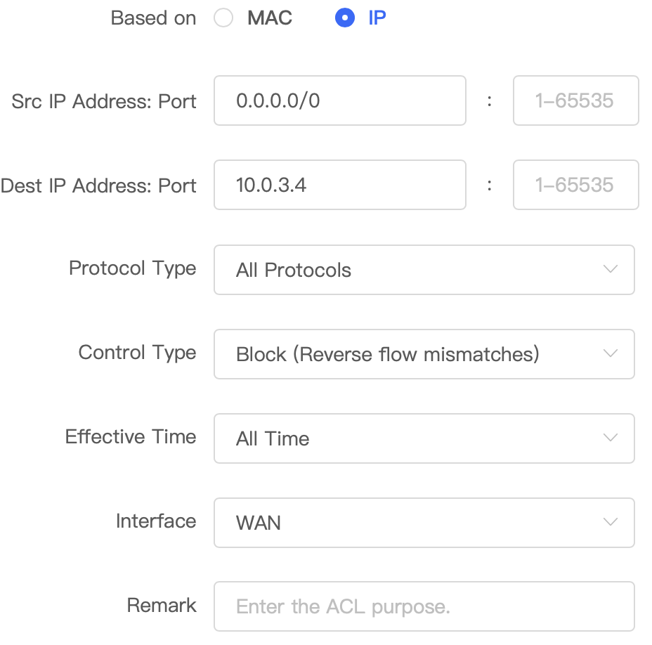

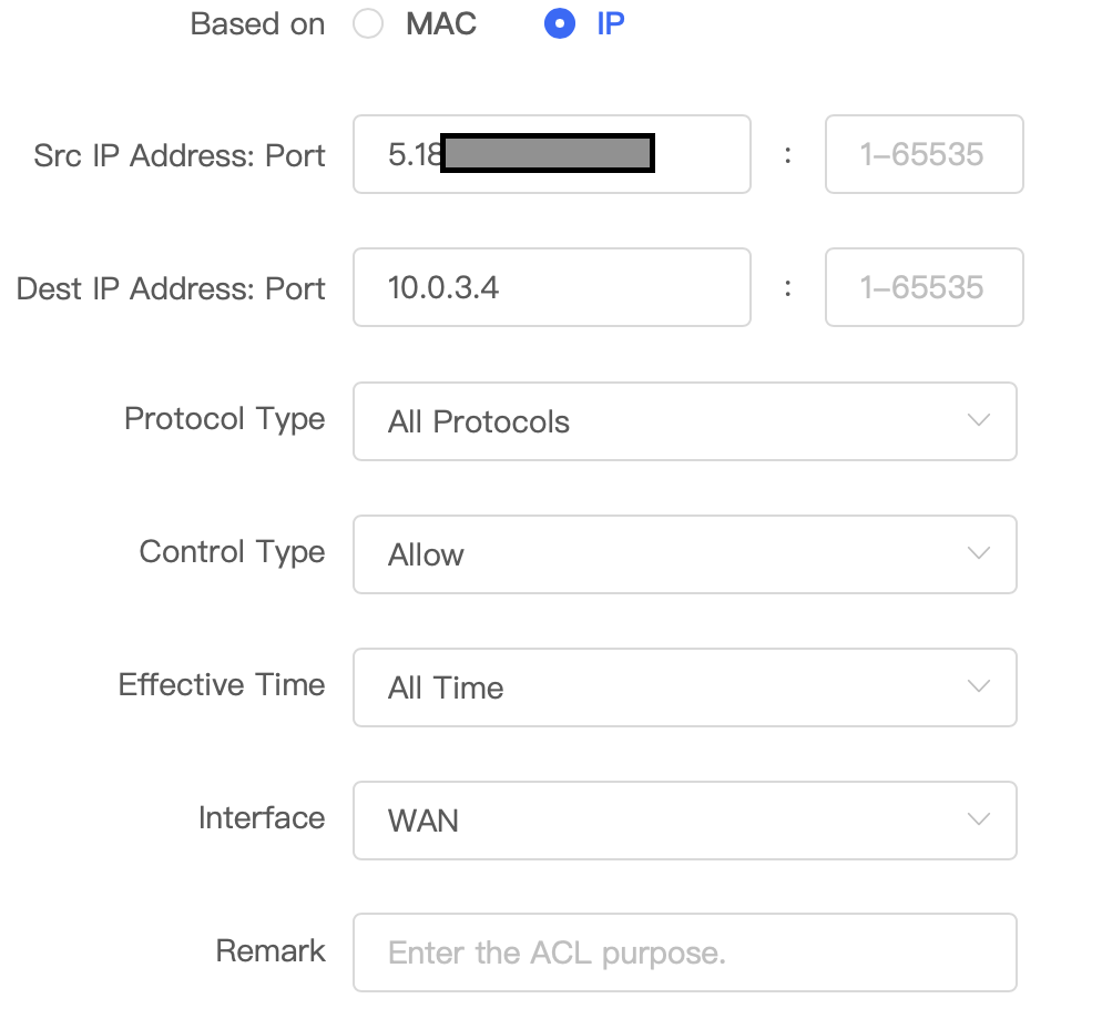

Hi,
I have a device on a Vlan which I need to reach from remote. To improve security I would like such device to be reachable only from a specific external IP.
I have set 2 rules on ACL/firewall but it doesn't work. I can still reach the device from any external IP.
Rule 1
Rule 2
How can I setup the rules to allow only a specific external IP to connect to the device on my lan at 10.0.3.4 ?
Thanks for helping.
RG-EG105G
Firewall Router
0 2022-12-19 10:48:36 View all replies

Hi, thanks for helping. I am not very familiar with the DMZ.
I have set the above rules and forwarded port 22 on the device I need to reach from remote.
Just to avoid misunderstandings, my aim is to make reachable port 22 on the device at 10.0.3.3 only from only a specific external IP.
As it is now, the port on such device can be reached from any external IP despite the ACL rules above.
I am not sure how DMZ will help to achieve the above.
I would appreciate if you can confirm if the ACL rules are correct and the DMZ is the solution for this problem.
Thank you.

I think there is a misunderstanding on what I would like to achieve.
I have a device (Raspberry Pi on a Vlan). The device IP is 10.0.3.3
I have set port forwarding on port 22. The port can be reached from internet.
I have set two rules in ACL as per my first post to restrict the external IP that can reach 10.0.3.3:22 to a single IP from internet.
The problem is that the rules on ACL do not prevent other IP to reach 10.0.3.3:22
The question is how to restrict external IP that can reach 10.0.3.3:22 from internet.
