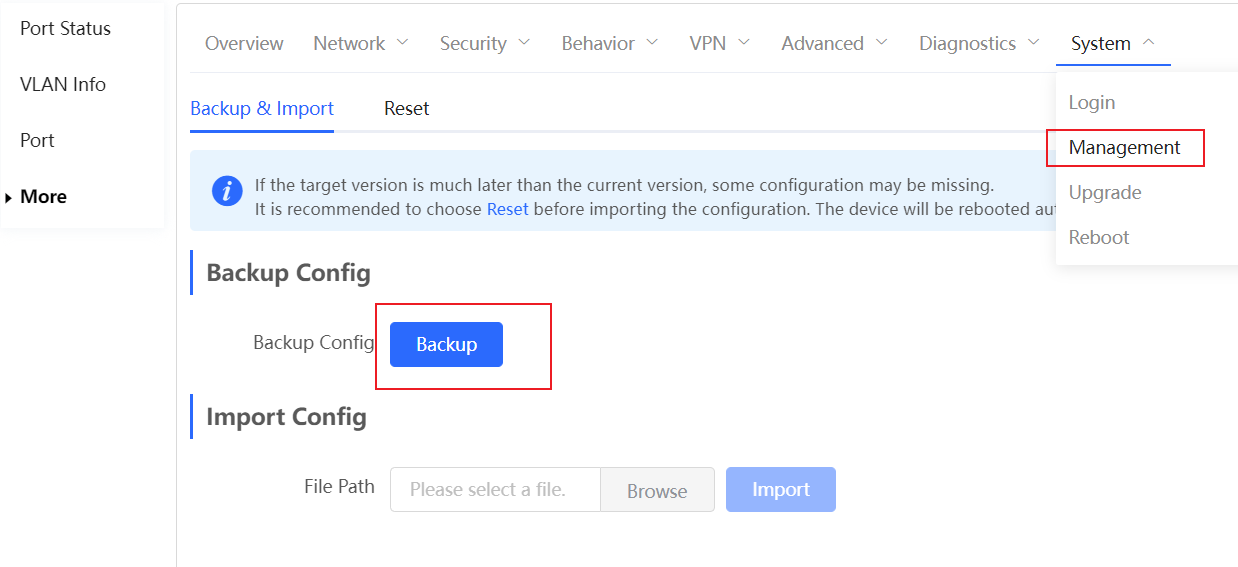

How do you backup the entire network configuration?
Is there a way to backup and restore the network configuration (router, switches and AP)?
Thanks
RG-EG105G V2

Could you provide the device model?
0 2022-12-19 12:03:37 View all replies
Patrick replied at 2022-12-19 11:02
Hi,
the router model is RG-EG105G V2
Thanks for helping
0 2022-12-19 12:15:48 View all replies
Felice Massaro replied at 2022-12-19 12:03
Hi,
For Reyee EG, you can check this picture to back up configuration:
But please note that, this can't back up all the device in whole network.
For backing up entire network, you need to login to device one by one.
0 2022-12-19 12:38:34 View all replies
Patrick replied at 2022-12-19 12:15
Thank you. This helps.
