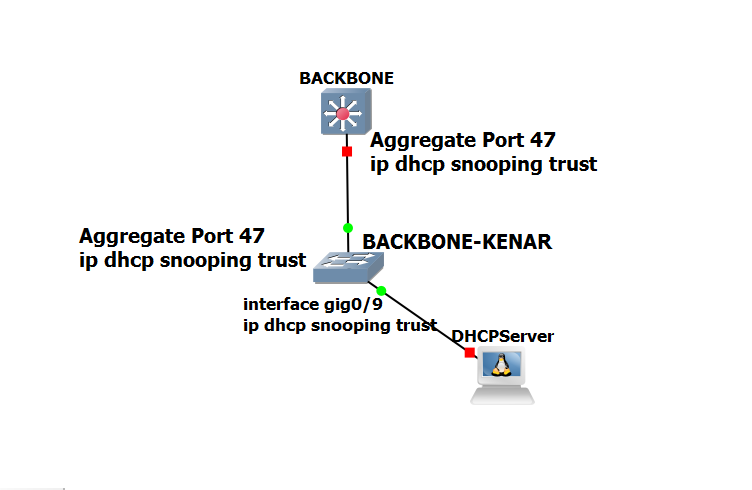

Hi,
On Ruijie RG-S6250-48XS8CQ series swithces, dhcp relay function does not work with dhcp snooping being on although dhcp server port is a dhcp snooping trusted interface.
The configuration is below, are there any extra necessary configuration with dhcp snooping with dhcp relay?

I want to know what is the phenomenon of DHCP relay doesn't work, the user of VLAN 50 and VLAN 95
can not get the address, right?
May I know what your topology? And how are your network segments arranged?
0 2023-1-6 21:58:53 View all replies
Micca replied at 2023-1-4 10:46
c ...
Yes. Topology is in attachment.
0 2023-1-9 09:35:52 View all replies
Ali Şiyar Türkdoğan replied at 2023-1-6 21:58
Thanks for sharing.
May I know the phenomenon of DHCP relay doesn't work? Which vlan cannot obtain the address?
BTW, you can try to add this command after you configure dhcp snooping trust port:
Ruijie(config)#ip dhcp snooping check-giaddr
Ruijie(config)#end
