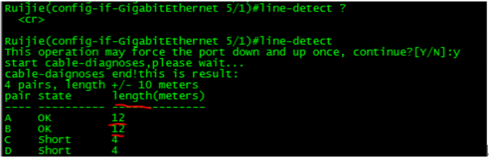

Our Ruijie switch can support link-detect function which you can check whether the network cable is normal and check the length of the network cable. But only the electric medium interface can support link-detect function, while the optical medium interface and the AP interface cannot support link-detect function. If you enable the link-detect function on a properly connected interface, the cable connection will be temporarily disconnected and then re-established.
Ruijie(config-if)#line-detect
