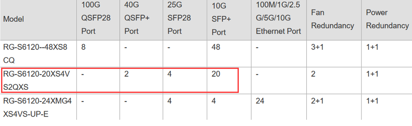

Can switch RG-S6120-20XS4VS2QXS use the 32 10G ports? Reply
3539 0 2023-1-18 14:20:32
2 40G QSFP+ ports can support 4×10G mode equals to8 10G SFP+ ports, 25G SFP28 ports can also support 10G, and the original 20 10GSFP+ ports, totally 32 10G SFP+ ports.
