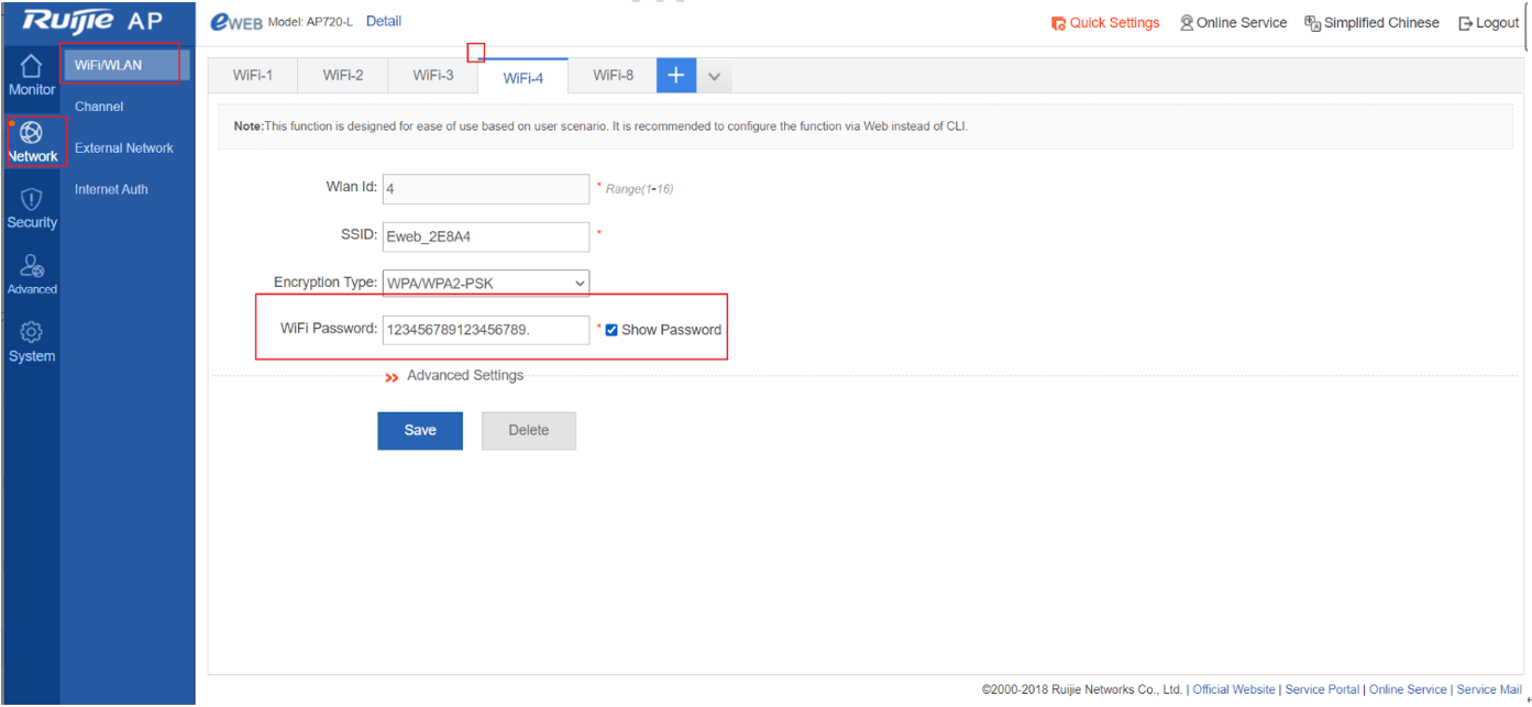

You can set SSID password with more than 16 bitsfor Ruijie AP according to the following two ways:
1.You can set it by AP local interface.
You can set SSID password with more than 16 bits for Ruijie AP according to the following two ways:
2.You can set it by AP CLI.
