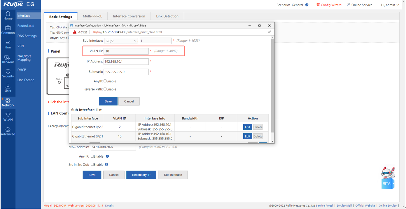

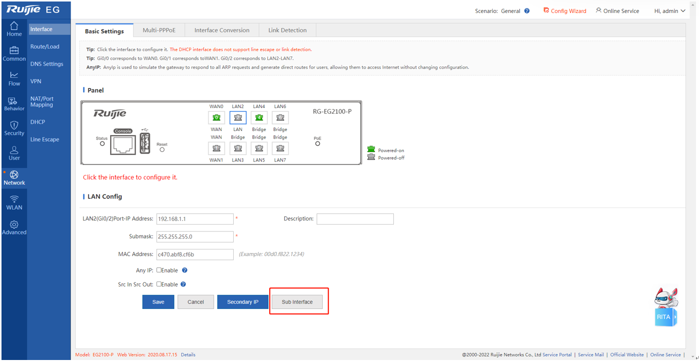

If you want to allow other VLANs to pass through the LAN port, you need to create a sub-interface under the LAN interface, Here we take VLAN10 as an example:
Web:
1.Select LAN port and then click "Sub interface."
1.      Configure VLAN10 and IP addresses
