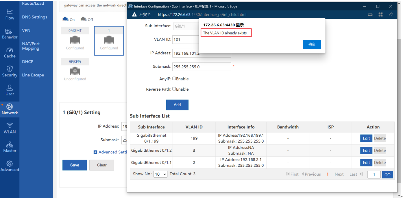

Sorry, it doesn't support.

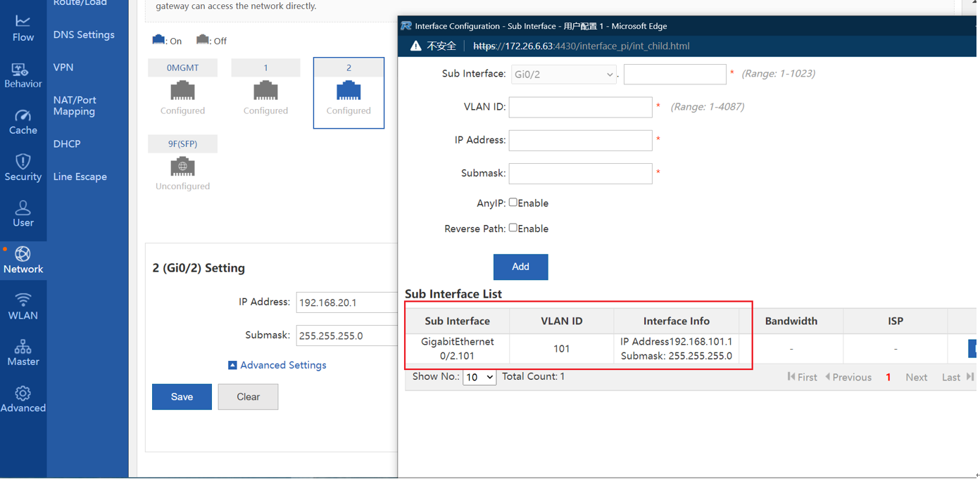

Configure the sub-interface of VLAN101 in G0/2
Configure the sub-interface of VLAN101 in G0/1,EG will pop up an error message "The VLAN IDalready exists."
