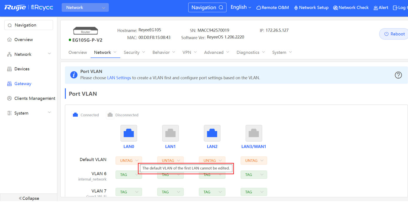

Can the UNTAG VLAN of Reyee EG's Lan 0 interface be changed to another VLAN? Reply

Sorry, the VLAN can't be changed. The UNTAG VLAN of the Lan 0 interface of Reyee EG can only be the default VLAN.

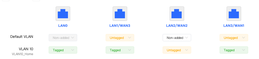

mine shows non-added, what can I do to get it back to untagged?
Dear sir,
Good day.
Because the LAN0 port needs to be reserved for the default management VLAN to ensure that we can access the device's management web interface normally.
Lex
