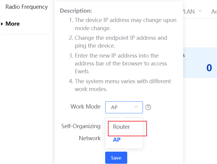

I am unable to configure NAT in my ap device, requesting for your assistant in NAT configuration
RG-RAP2260(G)
0 2023-1-21 11:10:31 View all replies
In AP mode, RAP does not support NAT.
You can change the work mode into Router mode.
By default, the WAN port will support NAT by itself in Router mode, which means you dont need to configure anything in eweb page.
But please note that, when you change the work mode, RAP will be factory reset.
