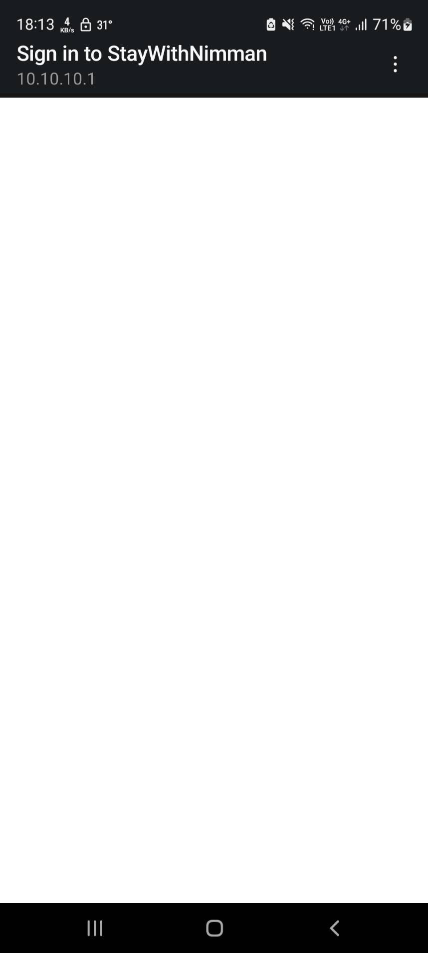

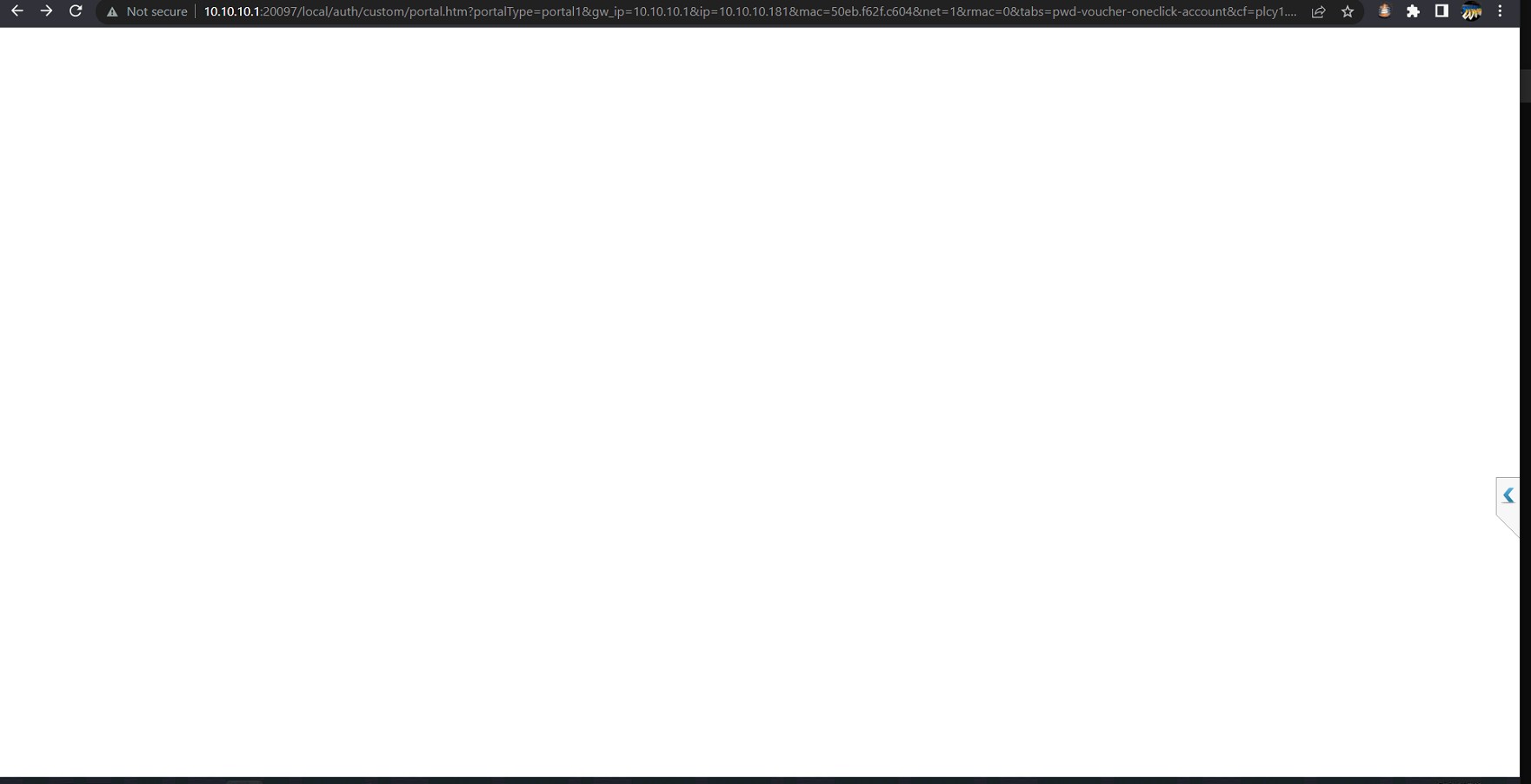

I got feedback from end user with local authentication gateway EG3230  firmware version RG-EG3200 Serial Gateway RGOS11.9(1)B11S3 after user sign-in successfully  found any a problem none show information it's error page. Please kindly help advise How to solve this issuing details as attachment,
1.Mobile Login success
2.PC Login Success

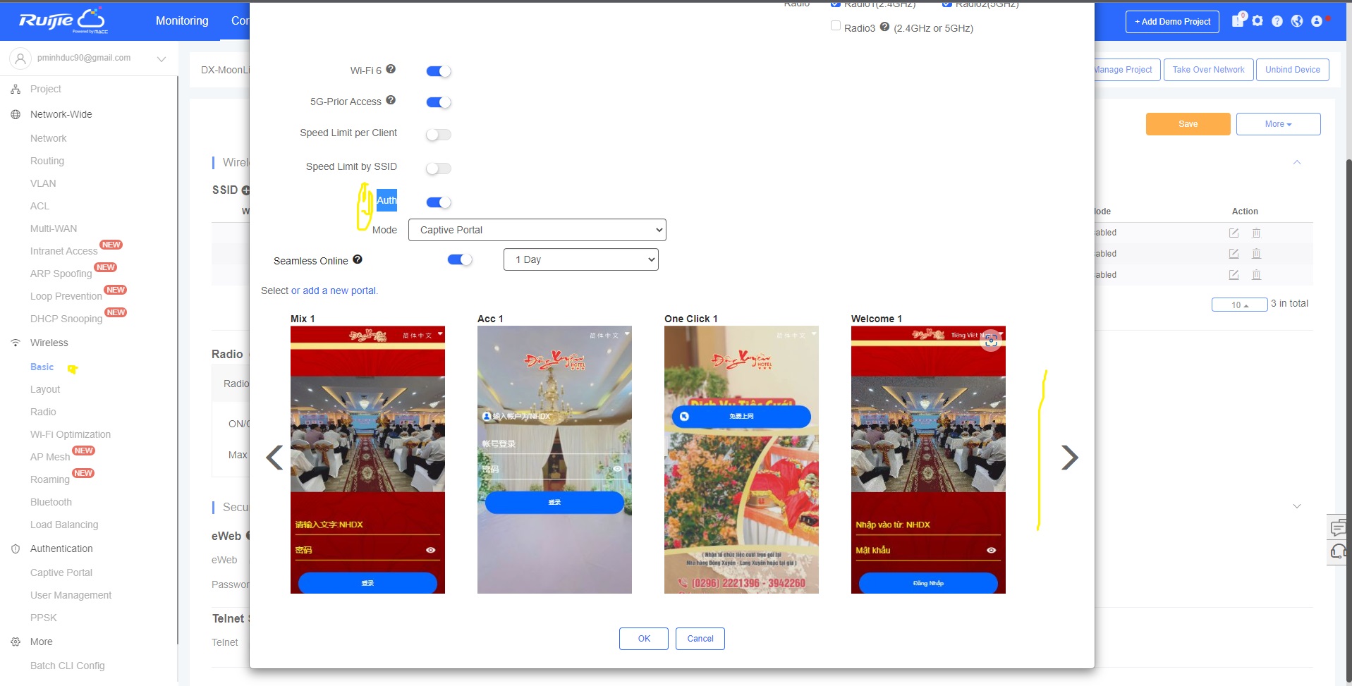

2) You go to the basic section of the wireless network. Select the SSID you want to apply the portal to, open auth mode and select the portal to apply, then select ok.

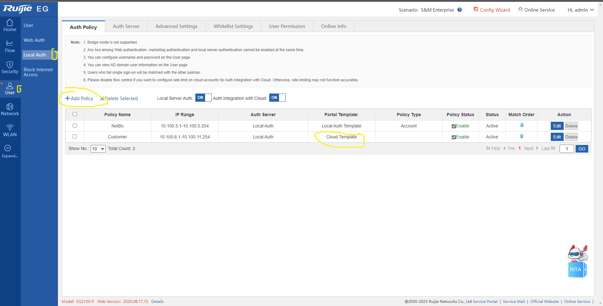

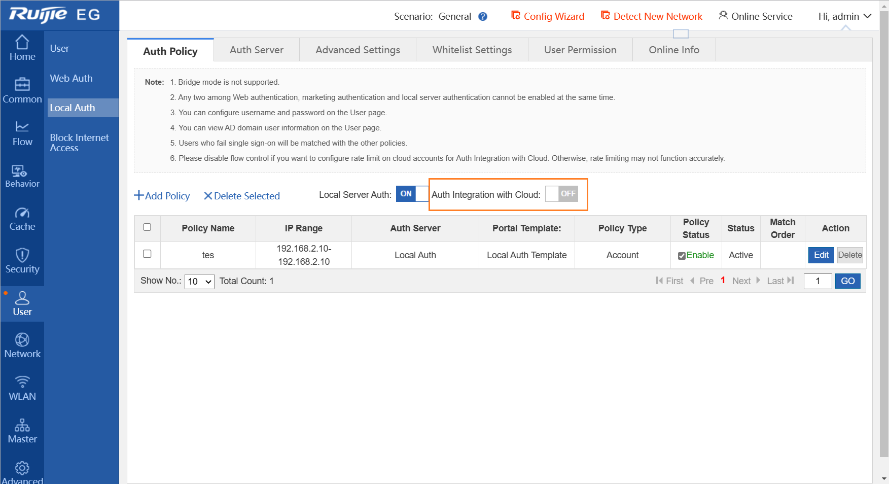

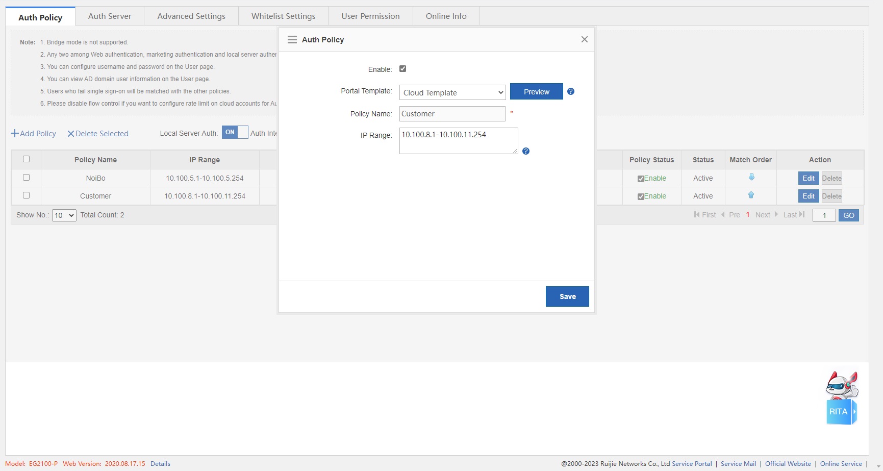

3) You access the eweb of the managed gateway, go to the user section, select local auth. Remember to turn on "Auth Integration with Cloud" then add a new policy, this will add the ip range of the vlan that you choose to run authentication, choose the portal template as the cloud template. You can click review to see if your portal shows up. and save it.

I can ask you a question about auth cloud tempalte. You see my post below #2 and #3. If I open both authentication methods at the same time. One is auth in the basic part of the wireless network and then select the portal at #2 and the other is Auth Integration with Cloud in #3, there will be a conflict that makes the portal not display and keeps loading when authenticating on the SSID.
Can you analyze for me, if I only apply 1 authentication way between auth with integrated portal capitive in #2 and Auth Integration with Cloud in #3, which option is optimal in terms of loading time option is the best in terms of data loading time and less bandwidth data.
