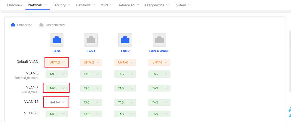

What does "UNTAG, TAG, Not Join" mean when configuring Port VLAN on Reyee EG? Reply
6033 0 2023-1-30 15:10:43
1.UNTAG
If VLAN 10 is set to the untag VLAN of port 2, VLAN10 will be the native VLAN of port 2. The packets from VLAN 10 will beforwarded over port 2 without tagging VLAN 10 and all untagged packets overport 2 will be regarded as packets from VLAN 10.
Only one untag VLAN can be configured on each port.
The native VLAN of port 1 is the default VLAN andcannot be edited
2.TAG
If both VLAN 10 and VLAN 20 are set to tag VLAN ofport 2, the packets from VLAN 10 and VLAN 20 will be forwarded over port 2 withthe corresponding VLAN tag.
3.Not Join
If both VLAN 10 and VLAN 20 are set to Not Join port 2, port 2 will not receive or transmit packets from VLAN 10 or VLAN 20.
