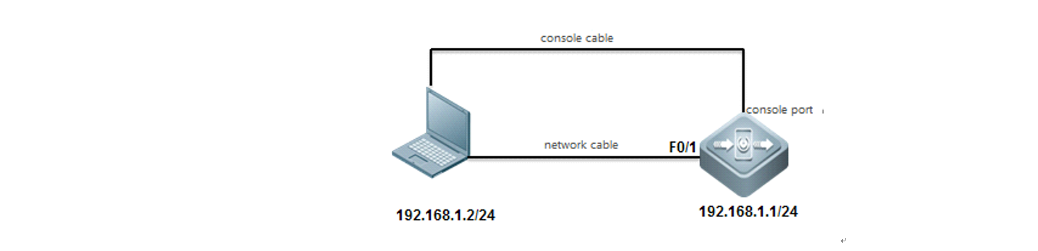

2. Topology

1. Switch can be connected through telnet and SSH.

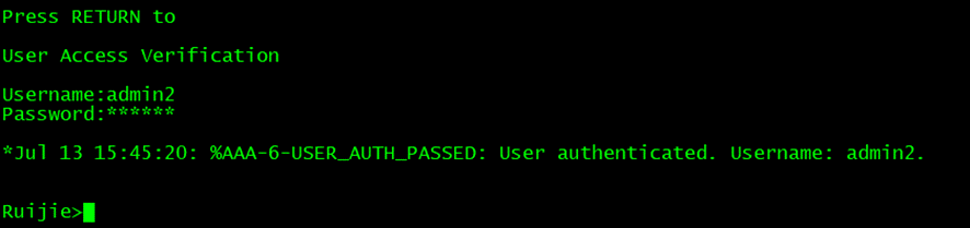

5. Result Verification
telnet login:
Username and password login:
