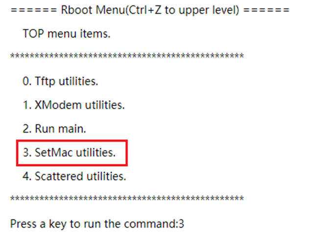

(This method requires you to log in to Ruijiedevice via console, so be sure to have the console cable ready first.)
When you can log in to Ruijie device via console, you can check the hardware version of your device in Boot by following these steps:
1.Console in Ruijie device, restart device, and press "Ctrl + C” when system prompts, enter Boot mode, input 3:

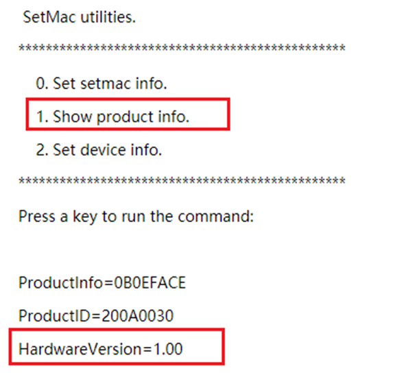

2. Input 1, then you can check the hardware version of your Ruijie device:
