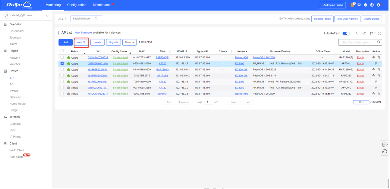

Ruijie AP can be configured with static IP Address through Web CLI, you can check these steps below.
1. Select the AP you want to configure and click 'Web Cli '.

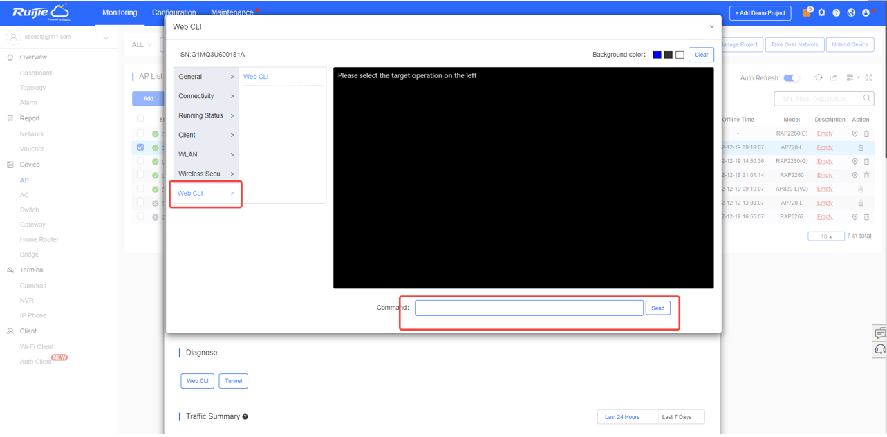

2. You can configure it with the following commands:
#config
#AP720(config)#ip route 0.0.0.0 0.0.0.0 xx.xx.xx.xx(gateway ip address)
#AP720(config)#ip name-server xx.xx.xx.xx(dnsserver address)
#AP720(config)#interface bvi 1
#AP720(config-if-BVI 1)#ip address xx.xx.xx.xxxx.xx.xx.xx (Configure the IP address and Mask you want to set)
