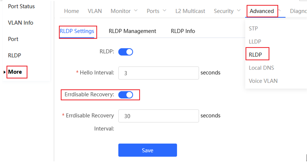

What can I do if I want the ports on the Reyee NBS switch that are blocked due to loop protection to be back in use after the loop is gone? Reply
3699 0 2023-2-1 15:05:45
You can turn on one function called ErrdisableRecovery in RLDP setting of Reyee NBS switch:
Enter More> Advanced > RLDP > RLDP Setting page, enable Errdisable Recovery, click Save.
