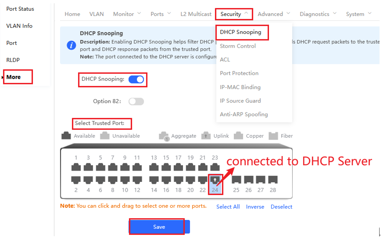

Reyee NBS Switch supports DHCP Snooping. You canconfigure it on the eweb of Reyee NBS Switch:
Enter More> Security >DHCP Snooping page, enable DHCP Snooping function, select the port that is connected to DHCP Sever as Trusted Port, and click Save.
