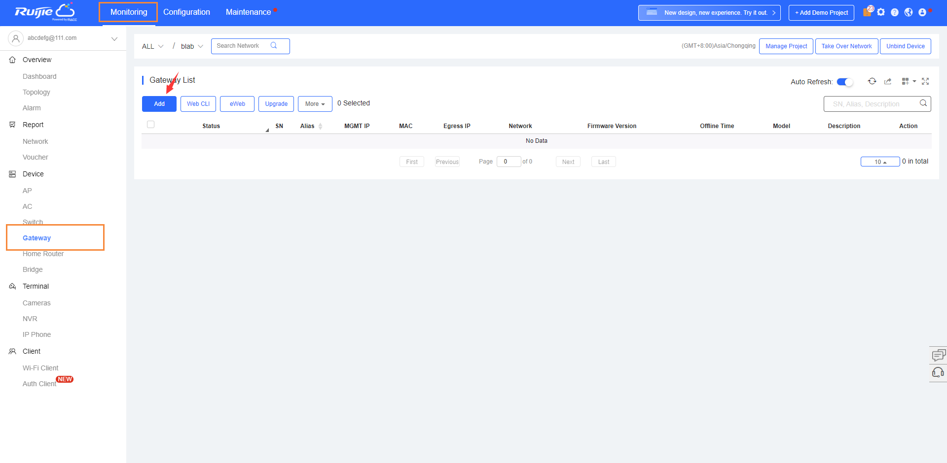

You can add the EG to Ruijie Cloud, then you can be able to manage it remotely.
The Asia Cloud website is cloud-as.ruijienetworks.com. You can add here to make it online on cloud:

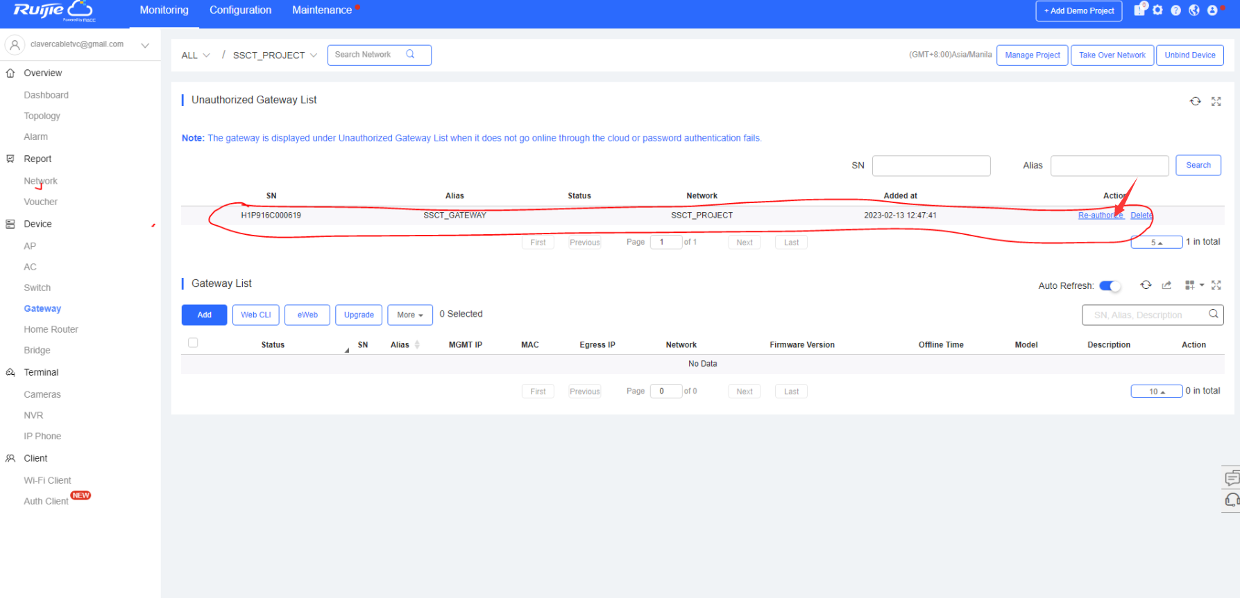

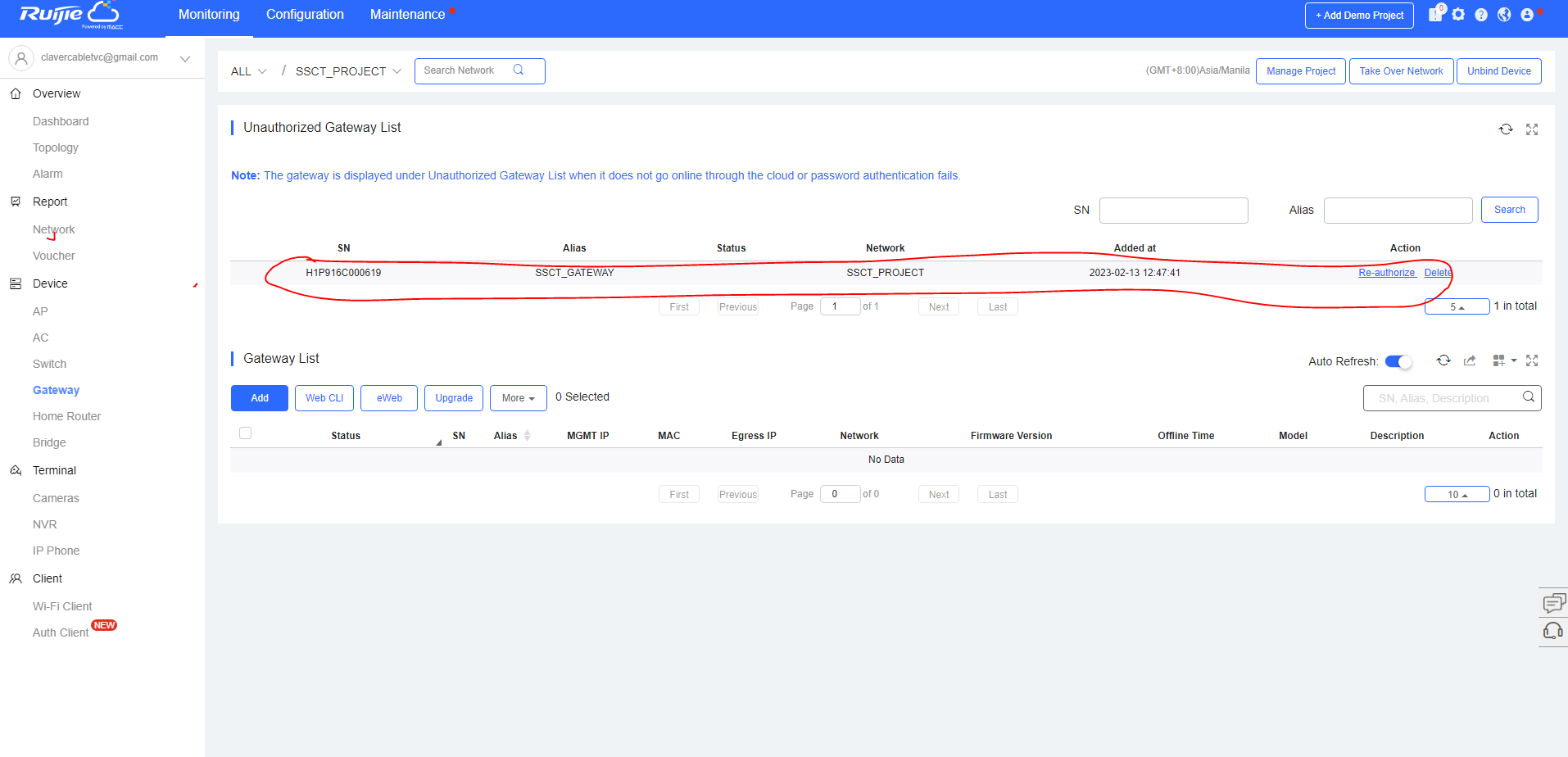

This will happened. There is something need to do in RG-EG3250?
0 2023-2-14 10:06:29 View all replies
ClaverCableTv replied at 2023-2-13 12:52
Please click re-authorize here and enter the device eweb password:
