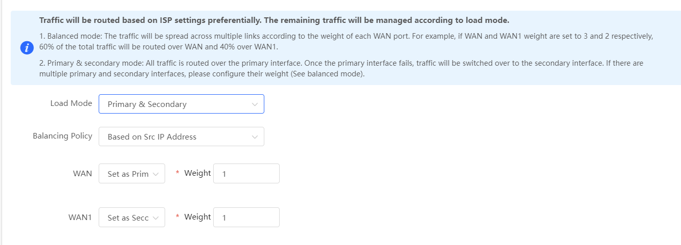

Hi! goodafternoon,
      I have concern about the Ruijie Reyee RG-EG105G V2 I try Primary and Secondary mode,  I want my set up the PRIMARY will be the top priority but the problem I've tried deffernt mode at 1st the primary will take effect as a priority when I disable the PRIMARY the SECONDARY will ang there was no problem with the secondary and when I enable again the PRIMARY sometime it will make the SECONDARY as a priority or sometimes the PRIMARY priority will effect my concern is there anyway that the PRIMARY will be always be the priority, when I disable the PRIMARY and after a minute I enable automatically the PRIMARY will be the priority not the SECONDARY can you help me with that?

Dear,
May I know are you mentioned this load setting?
May I check your setting, please?
Looking forward to your kind reply.
