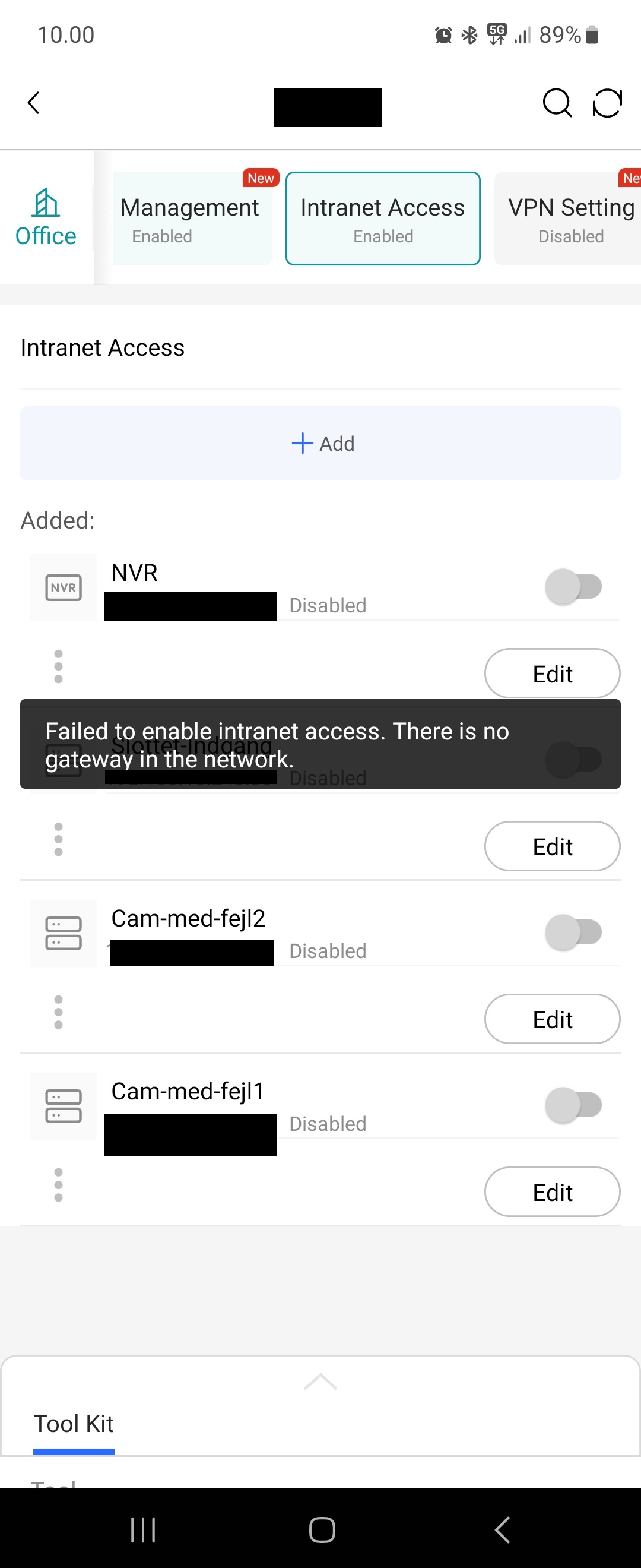

The error is something with a missing Gateway, but that makes no sense since it works when i logon to the cloud via browser?
If it works one place why doesnt it work the other, its the same function.

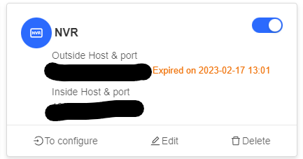

Hi Steve
here is a picture of it working on the a browser:
here is the screenshot of the error on the phone app:
My Customer asked a live chat person about this and his answer was that its becuase that there is no gateway, but why does it work online then?
Tbh i dont think that answer is correct....

Rasmus replied at 2023-2-17 17:06
Hi Steve
