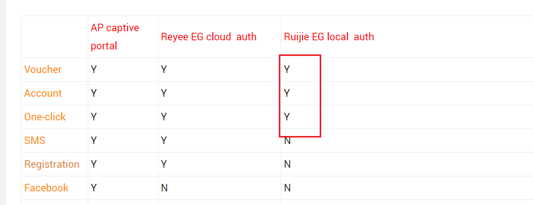

Dear sir,
For EG2100P captive portal, The supported types are as follows:
It cannot support  QR codes auth.May I know where you saw the description?

Dear sir,
This is configured on AC, like WS6008, not configure on EG.
