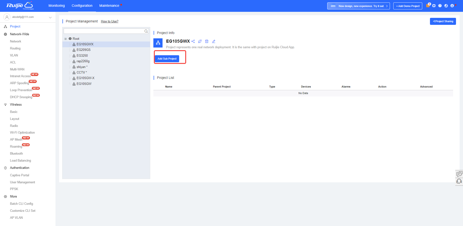

You can create different sub-projects for different floors on the Cloud, then put the APs of different floors into the corresponding sub-project, and create the SSID of each floor in the sub-project
