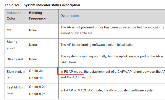

After factory reset, ruijie AP will be in the Fit mode.
You can check the hardware guide about the LED status of AP820-L(V3) in Fit mode:
https://www.ruijienetworks.com/resources/preview/77234?t=638138139210205078
Could you connect your PC to AP's LAN 1, set IP of your PC into 192.168.110.x/24, then login to the eweb of this AP via this default ip: 192.168.110.1?  Check if the eweb of AP is available or not.
