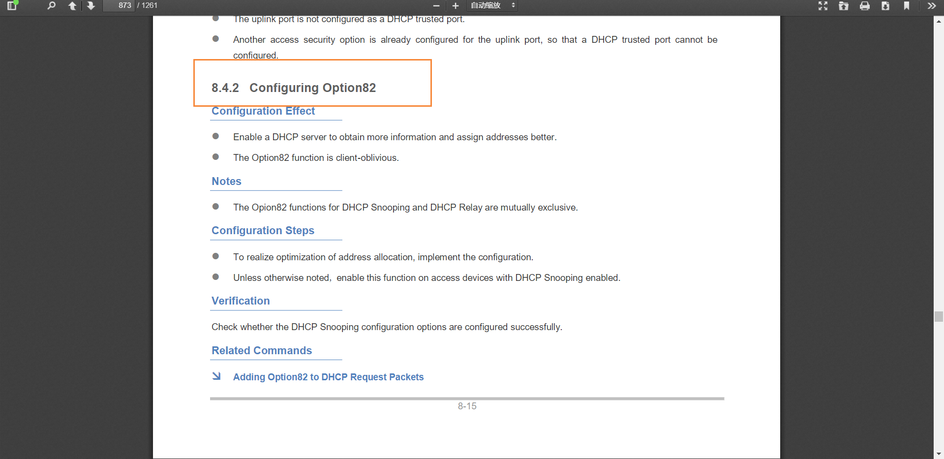

You can configure DHCP option 82 on Ruijie Fit APs:
Ruijie(config)# ip dhcp snooping information option
You can also follow this guide on page 874:
https://www.ruijienetworks.com/resources/preview/75585?t=638042859624492187
Note:
1. The Opion82 functions for DHCP Snooping and DHCP Relay are mutually exclusive.
2. Enable this Option 82 function on access devices with DHCP Snooping enabled.
Jenny
