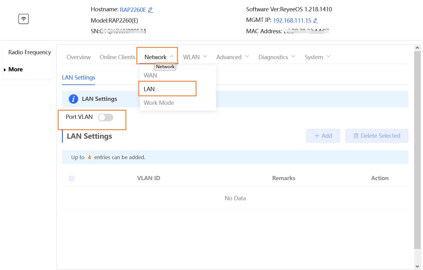

I test on my side that Reyee mesh APs can also support port vlan to create multiple vlans for different networks. You can configure on this page:

Thank you but that is not quite my question. My question is whether the mesh wireless connection between APs can carry tagged vlans. That is allright, I hope this feature will be added in a future update.

Yes, I test on my side that it can also bring the tagged vlan in the mesh network.
