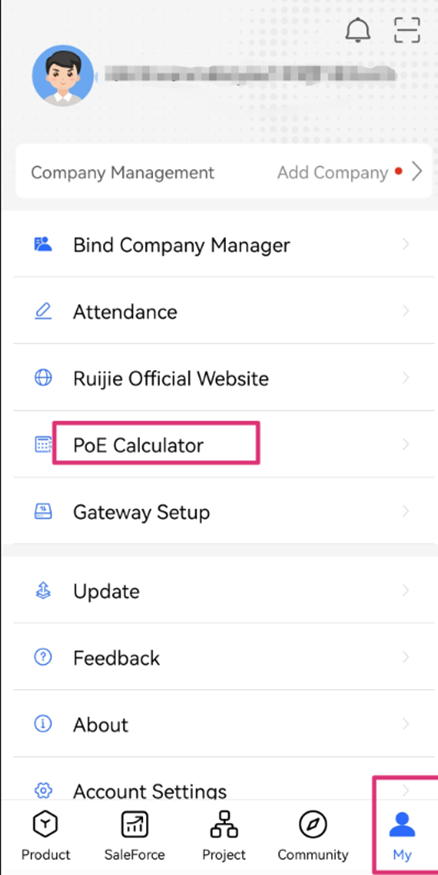

1.Click 'My' -- 'PoE Calculator'.

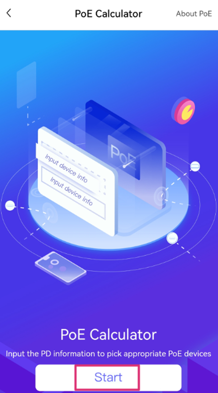

2. Click 'Start'.

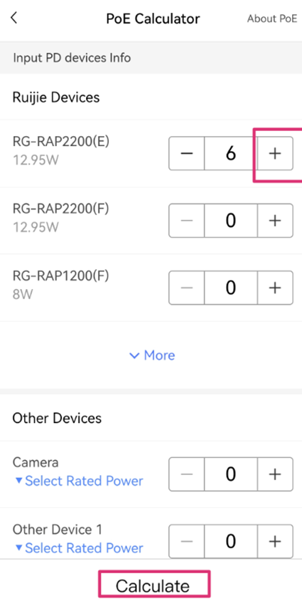

3. Choose the PD devices and input the number, then click Calculate.

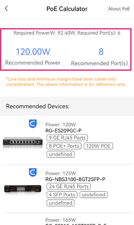

4.You can see the result here and the recommended PoE devices.
