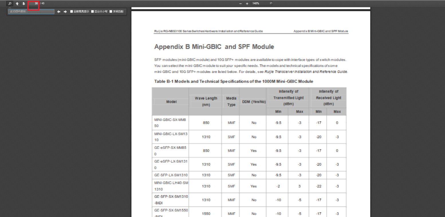

Have NBS3200-24GT4XS-P connected with NBS3200-8GT2SFP on fiber module XG-SFP-LR-SM1310, can't work with that module mayble the problem is the 8GT switch not sfp+ suports and the module XG is 10GBASE? Anyone can tell me the correct module for the nbs series sfp and sfp+ switches?

Do you refer to that NBS3200-24GT4XS-P and NBS3100-8GT2SFP both use their own fiber module to connect with each other? Since NBS3100-8GT2SFP only supports 1000MBase, so the fiber module of NBS3200-24GT4XS-P has to be 1000M.
Here is the list of the applicable 1000M modules for NBS3200-24GT4XS-P.
RG-NBS3200-24GT4XS, NBS3200-24SFP8GT4XS, NBS3200-24GT4XS-P, NBS3200-48GT4XS, NBS3200-48GT4XS-P Series Switches Hardware Installation and Reference Guide (V1.0).pdf (ruijienetworks.com)
On the page 41, Table B-1.
The list for NBS3100-8GT2SFP is below.
RG-NBS3100-24GT4SFP, NBS3100-24GT4SFP-P, NBS3100-8GT2SFP, NBS3100-8GT2SFP-P Series Switches Hardware Installation and Reference Guide (V1.0).pdf (ruijienetworks.com)
The page 36, Table B-1

Thanks a lot Edwin now i can try with correct modules.
