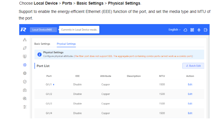

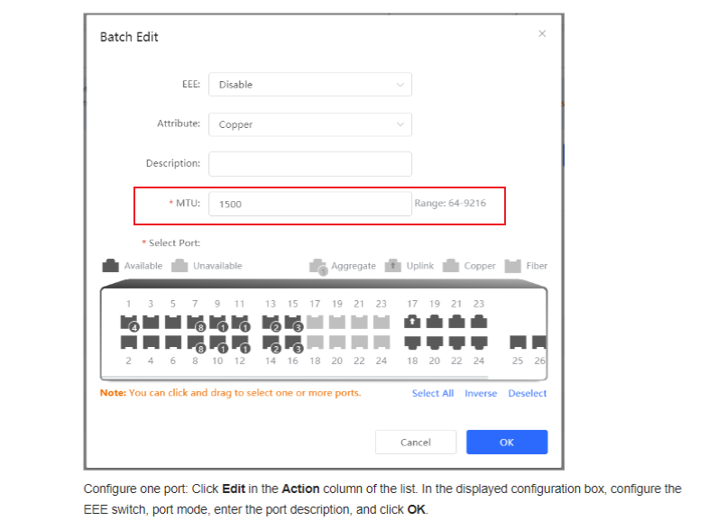

Dears,
Im wondering to know how we can change the MTU size on the switch "RG-NBS3100-8GT2SFP"
RG-NBS3100-8GT2SFP
Switch
0 2023-4-10 10:50:31 View all replies
Here is the configurationb guide for your reference in case you need it( in page 107) :https://www.ruijienetworks.com/resources/preview/77338
