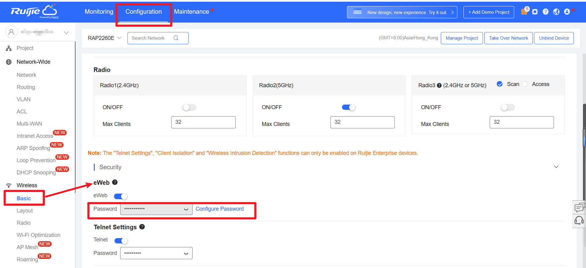

Could you please check eweb password as follows?
If you cannot log in with this password, you can
configure a new password to do a test.
i already tried but still can not reach the interface from browser

Because this switch is not go online on cloud, the password on cloud not sync to switch, could you please login into switch by console to change eweb password as follows?
