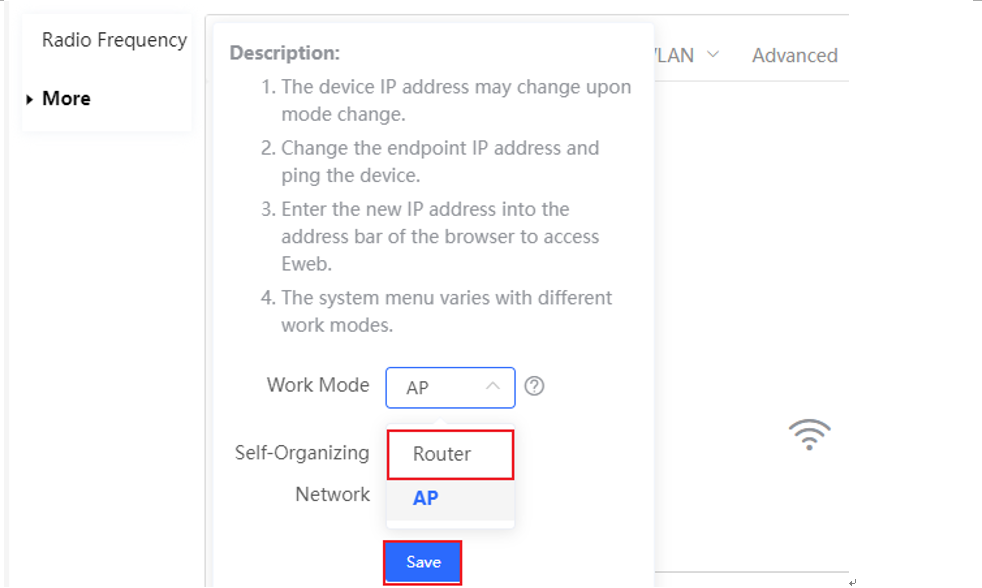

Does Reyee AP support NAT configuration via local eweb? Reply
4155 0 2023-4-14 10:11:14
Reyee AP works in AP mode by default, in which theWAN port of Reyee AP does not support NAT.
You need to change the work mode from AP mode toRouter mode. Under the Router mode, the WAN port of Reyee AP can support NAT.
Note: When you change the work mode, Reyee AP will be factory reset.
