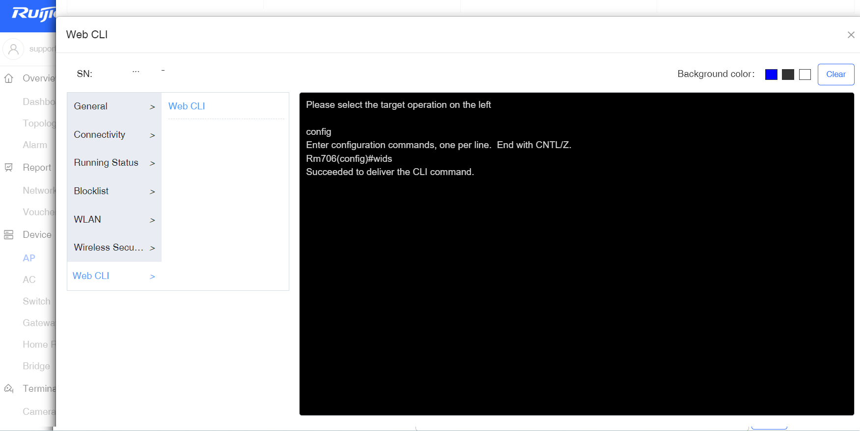

I am having trouble go into the wids mode on my AP Model :
AP840-I
I wait for a few minutes and still stay on the above screen.  I even tried to submit a few times by typing wids. It just won't display the next screen.  Any cue ? It applies to all my 80 other APs.

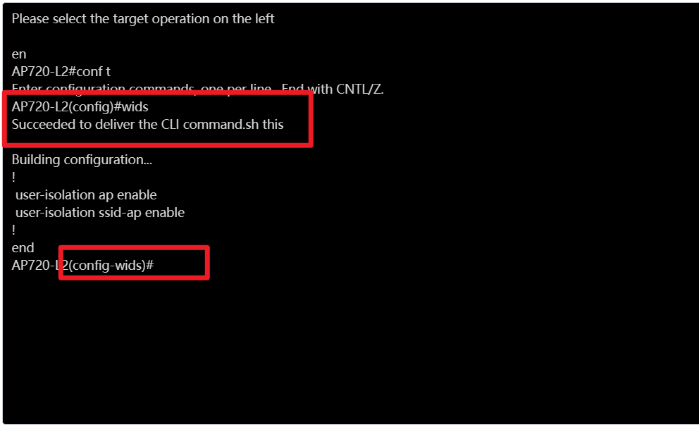

Hi sir,
After you enter wids into web cli, you're actually in wids mode, you can type the commands you want as follows:
