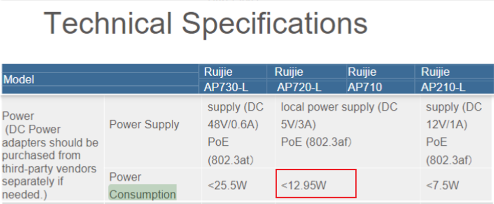

Power Consumption of AP720-L is <12.95W

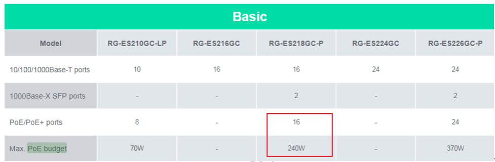

Max. PoE budget ofES218GC-P is 240W, but only has 16 ports for POE
So it could theoretically power 16 APs
