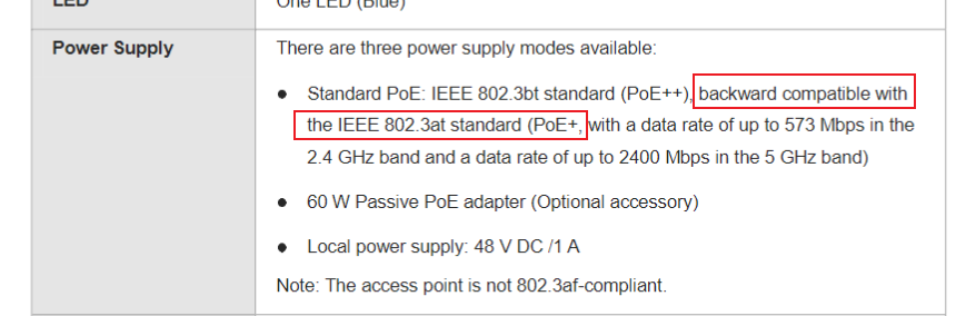

RAP2260(H) can support PoE++ at most.
For now, NBS 3200 series switch does not support PoE++ funtion.
If you want to power this AP model by NBS3200, you need to choose poe+ for the compatibility:

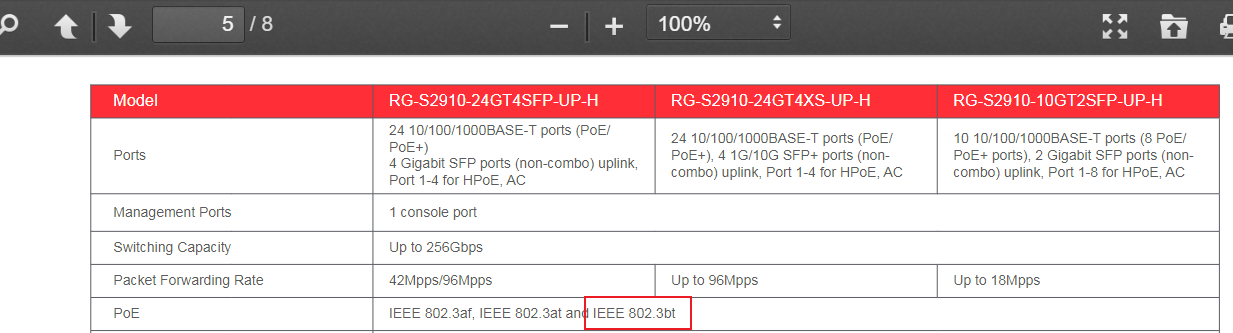

Which Ruijie or Reyee switch model supports POE++?
0 2023-4-18 17:12:32 View all replies
Mario replied at 2023-4-18 12:02
RG-S2910-24GT4XS-UP-H can support.
Please kindly check this datasheet:
https://www.ruijienetworks.com/resources/preview/58617?t=638174345103281250
