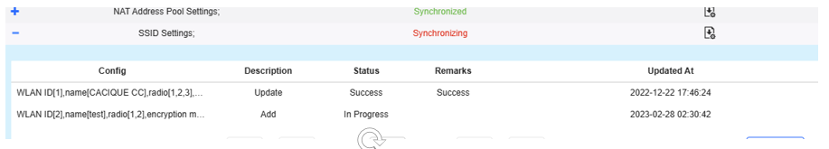

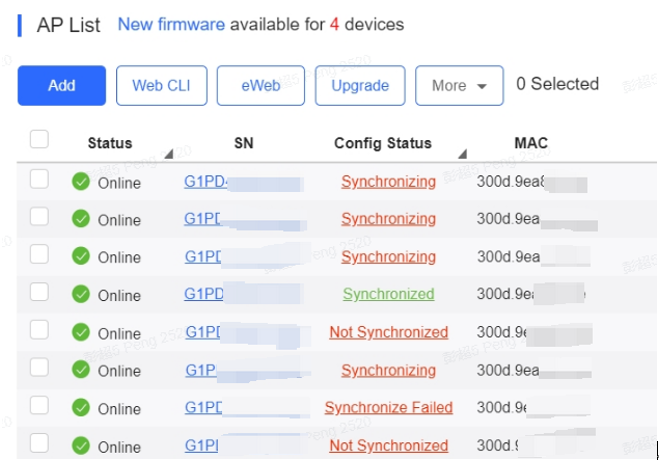

Device configurations on Ruijie Cloud fail to be synchronized to devices. The devices are in the online state, but their configuration state is "Synchronizing, Not Synchronized" or "Synchronize Failed."

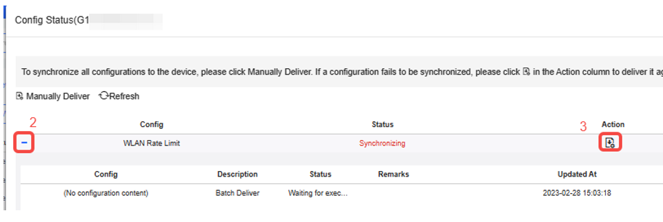

(2) If some configurations still fail to be synchronized after 10 minutes, the failure may be caused by synchronization timeout. Perform the steps shown in the following figure to manually synchronize the configurations that fail to be synchronized:

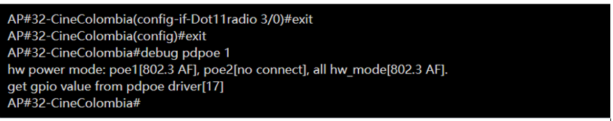

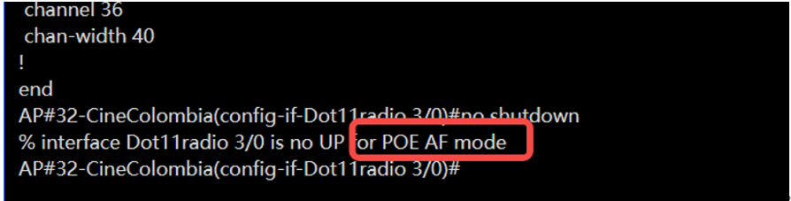

(2) Devices fail to be configured. The possible cause is configuration conflicts or device restrictions on the devices, resulting in a command execution failure. Run commands on the CLI to manually configure the devices. In the following example, the cloud delivers configurations of radio 2 and radio 3. However, because devices are powered in PoE AF mode, radio 2 and radio 3 are disabled on them, resulting in asynchronization failure.
(3) If devices fail to be manually configured, collect a snapshot of reported errors and contact Ruijie Online Support.

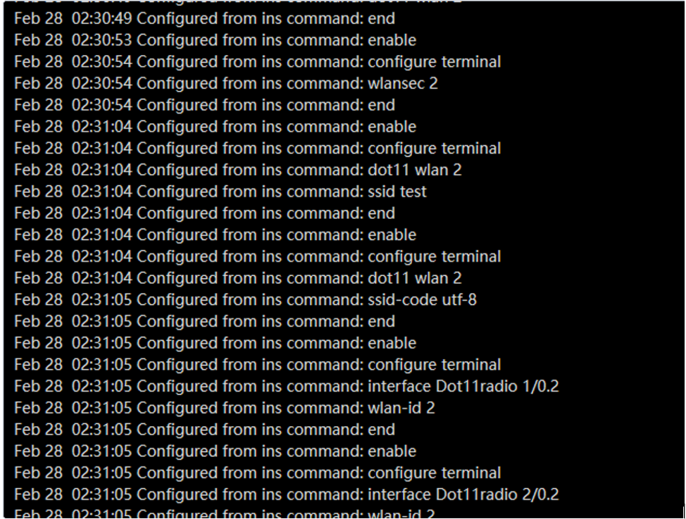

Run the show cli record command to display command execution records on the devices, and check whether the devices execute commands delivered by the cloud.
As shown in the following figures, after SSIDs are created on the cloud, you can run the show cli record command on the devices to display command records.
(1) If no execution record is displayed, the devices may not receive configurations delivered by the cloud. Check whether security policy restrictions are configured on the network and enable the ports for devices to access the cloud: TCP ports 80, 443, and 25857, and UDP ports3478 and 3479.

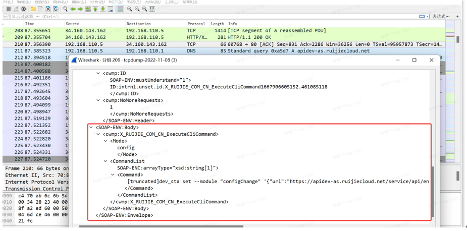

(2) If the ports are enabled but configurations still fail to be synchronized, perform packet capture on upstream devices and trigger configuration synchronization during packet capture. Analyze whether configuration delivery packets are received. The following figure shows packets of commands delivered by the cloud.
