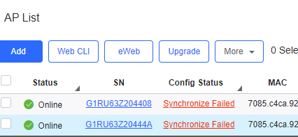

Need your assistance please. I have 2 X RAP 2200F connected to ES205GC-P which is uplinked to my EG105G-V2. The two wireless AP status are "Synchronize Failed". Please refer to the attached file.

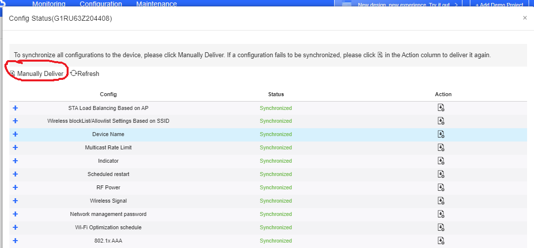

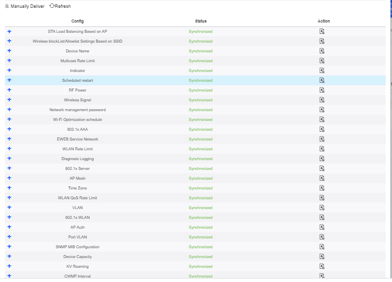

However when I click on the device SN it shows that everything are sync accordingly. What could be the possible workaround for this to solve? Thanks.
0 2023-5-1 17:08:06 View all replies
JEff De la Cruz replied at 2023-5-1 16:58
However when I click on the device SN it shows that everything are sync accordingly. What could be t ...

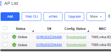

I found the workaround by reading posts similar to my issue. I just clicked on the Manually Deliver then refresh the page, problem solved. The AP's are now synchronized.
