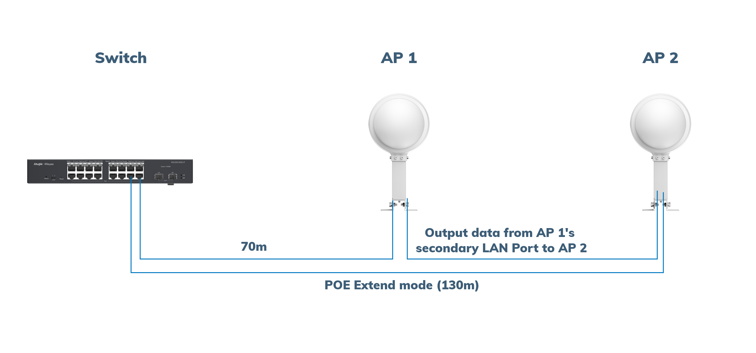

Hi,
I have a project that required to run about 130 meters of CAT-6 cable. I understand there is POE extend mode but it only supports 10Mbps. So I'm thinking like this
  • There are 2 RAP6262 (Lets say AP A and B)
  • AP A is just 70m from switch and AP B is 130m from switch
  • Can I use AP A's secondary LAN Port to output data to AP B?
Another option is to have Mesh network but It's about 50m away in open rooftop and not sure if it will work. Any suggestion is welcome!
I have attached draft diagram. Thanks in advanced!

Can I use AP A's secondary LAN Port to output data to AP B?---->Sorry it can not support coz AP lan port can not supply poe power to APs.
Another option is to have Mesh network but It's about 50m away in open rooftop and not sure if it will work.--->You can use mesh function, but AP2 needs to be powered by a separate power adapter and the recommended distance between Root AP and Mesh AP should be less than 10m and RSSI > -70dBm. You can refer to this link: https://community.ruijienetworks.com/forum.php?mod=viewthread&tid=4423&extra=page%3D1

Hi,
Thanks for your reply.
Option 1: I understand that there is no POE power from AP-A to AP-B. But can AP-A output data (no POE power) to AP-B via 2nd LAN? I just want to pass the data from A to B and I will get AP-B power source from somewhere else.

Yes, sir. AP-A can transfer the traffic data to AP-B through the lan port.
