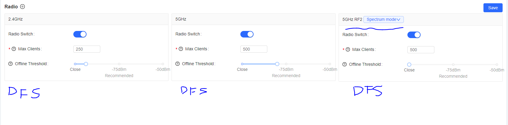

Dear Sir,
It's possible to enable DFS on Ruijie Cloud Controller?
and What radio 3 used for?
Thank you

Dear Sir,
Ruijie Cloud does not support DFS. The radio switch function is to turn the radio on/off on the APs of the project, if the 2.4G radio is turned off, users will not be able to connect to the AP on the 2.4G band. The radio 3 is only applicable to certain models that have a third radio.

Dear Mr. Jayden,
Why DFS not support again in Ruijie cloud, and do you have any solution, I have terrible with channel interference and I don't want to change manually if channel usage overload
Thank you

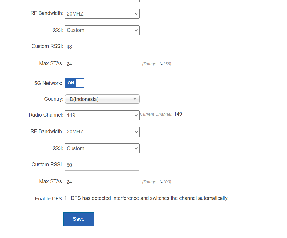

Dear Sir,
May I please know the AP models used in your project? Some models would support DFS while some do not. If the device support enabling DFS, you may use the CLI Command function on Ruijie Cloud to deliver the commands to the devices based on its model:
1. you may refer to this post on how to configure CLI Command: https://community.ruijienetworks.com/forum.php?mod=viewthread&tid=1760
2. the commands to enable DFS on supported models:
conf t
int dot11radio 2/0
dfs enable
end
wr
