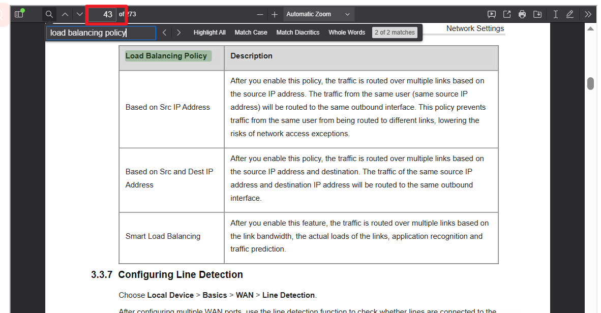

Dear Dan,
"Smart Load Balancing" function means:
After you enable this feature, the traffic is routed over multiple links based on the link bandwidth, the actual loads of the links, application recognition and traffic prediction.
Here is the web-based Configuration Guide with many functions' explanation which you can refer to.
RG-EG Web-based Configuration Guide, Release ReyeeOS 1.216(V1.2) (ruijienetworks.com)
And the related explanation of Load Balance Policy, you can find it on page 43.
Edwin
