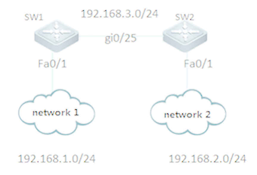

a) Requirement
Configure the switch with static routes and ensure that users in network 1 can communicate with users in network 2
b) Topology:
Configuration Tips
1) Assign IP addresses to SW1 and SW2
2) Configure Static Routes on SW1
3) Configure Static Routes on SW2
4) Save Configuration

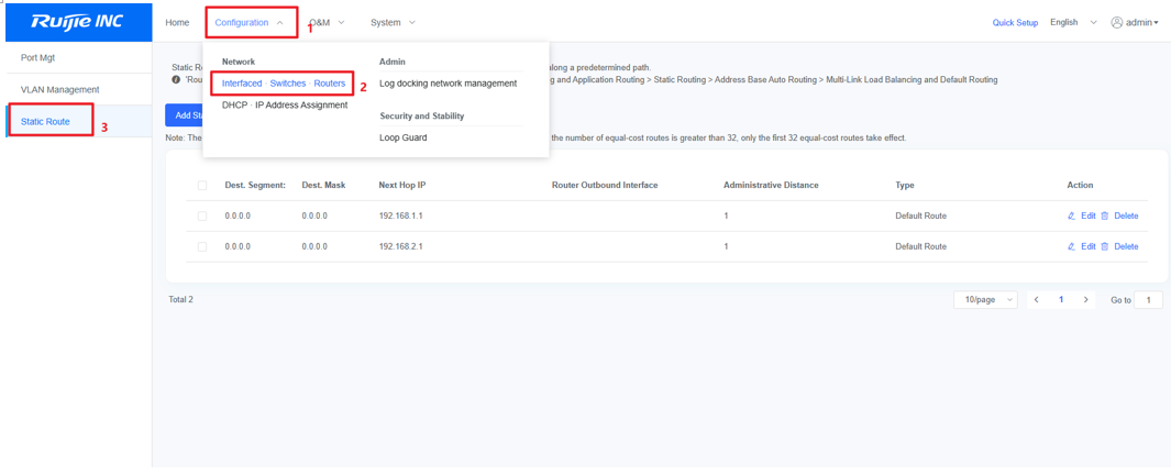

1) The location of this function on the eweb page
Configuration—Interfaced•Switches•Routers—Add Static Route

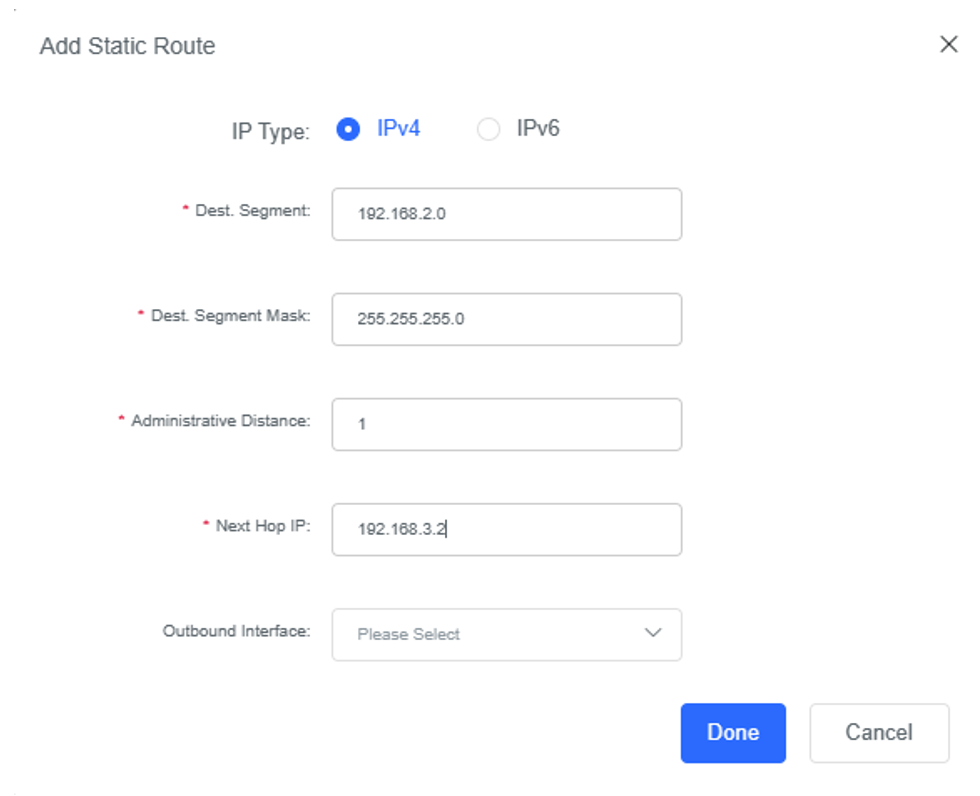

2) Configure Static Route on SW1
Administrative distance: The lower the administrative distance value, the higher the priority of the route.
The default value for static routing is 1.

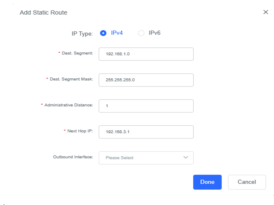

3) Configure Static Route on SW2
Note:
1) When you configure static routes, there're two ways to specify next hop. Youcan specify an IP address ,or you can specify a local outgoing interface.
2) We suggest you use IP address as next hop

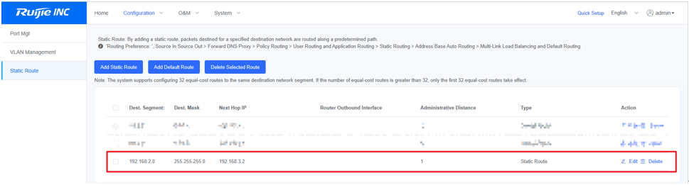

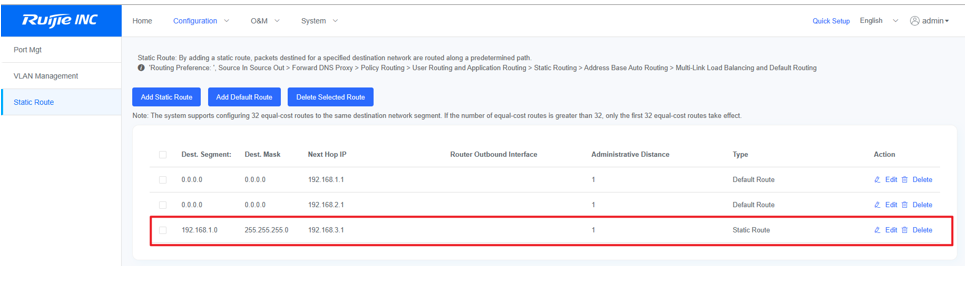

Verification:
SW1:
SW2:
