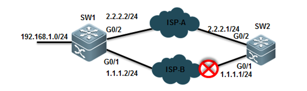

Static routing and BFD linkage example
Case of Configuration
a) Requirement
SW1, as a financial network aggregation switch, accesses two MSTP links, using floating static routes, with ISP-B as the primary link and switching to the ISP-A link in case ISP-B is not available. There is no detection mechanism for the Ethernet link, as long as the interface is UP, the line is considered available. So it is necessary to use the BFD protocol, as a link detection protocol.
b) Network Topology
c) Configuration
Configuration on SW1:
1) Configure IP addresses and floating static routes

Verification
1) Run the "show bfd neighbors" toconfirm the status of BFD neighbor
R1#sh bfd nei
OurAddr           NeighAddr           LD/RDRH/RS    Holdown(mult)  State Int
1.1.1.2                  1.1.1.1                      2/1  Up            0(5   )  Up    GigabitEthernet 0/1
2) View the routing table by "show iproute"
3) With the correct configuration and link, tracertthe intranet address of the aggregation end on the SW1 to confirm that the pathgoes to ISP-A
4) SHUTDOWN the G0/1 interface on SW2 to simulate anoperator ISP-A failure; then tracert the intranet address of the aggregationend on SW1 to confirm the path switch to SW2.

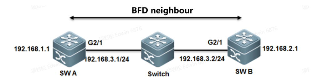

OSPFrouting and BFD linkage example
Caseof Configuration
a) Requirement
The Layer 3 switches SWA and SWB are interconnected via the Layer 2 switch, running the OSPF protocol on the devices to establish routes and allowing OSPF to associate BFD applications on both interfaces. In the event of a link failure between the SWB and the Layer 2 switch, the BFD can quickly detect and inform the OSPF protocol, triggering rapid convergence of the protocol.
b) Network Topology
c) Configuration
Configuration on SWA:
1) Configure IP address and OSPF route
SWA>en
SWA#config ter
SWA(config)#interface gigabitEthernet 2/1
SWA(config-GigabitEthernet 2/1)#ip address192.168.3.1 255.255.255.0
SWA(config)#interface gigabitEthernet 1/1
SWA(config-GigabitEthernet 1/1)#ip address192.168.1.1 255.255.255.0
SWA(config-router)#router ospf 123
SWA(config-router)#network 192.168.3.0 0.0.0.255area 0
SWA(config-router)#network 192.168.1.0 0.0.0.255area 0
2) Configure OSPF and BFD linkage
SWA(config-GigabitEthernet 2/1)#bfd interval 500min_rx 500 multiplier 3
------>Configure the BFD time parameter. This command also enablesthe BFD function of the interface, so it must be configured; 500/500/3 is therecommended configuration here, sending a probe message at 500ms interval, anddeclaring the link failure if no response is received 3 consecutive times. Itis recommended to configure the same parameters at both ends of the BFD sessionto ensure that the associated BFD application protocols take effect at the sametime and to avoid a single-pass forwarding path due to the differentsuppression times configured at both ends.
SWA(config-GigabitEthernet 2/1)#no bfd echo
------>The default is bfd echo mode,at some times (such as there is a FW in the middle or docking devices of otherbrands) may filter the echo messages resulting in the BFD not being establishedsuccessfully, it is recommended to disable it. When docking with devices ofother brands, some of the devices do not support echo mode by default. If it isturned on at our end, session down may occur.
SWA(config-router)#bfd all-interfaces
        ------>Enable ospf and BFD linkage
Configurationon SWB:
SWB(config)#interface gigabitEthernet 2/1
SWB(config-GigabitEthernet 2/1)#ip address192.168.3.2 255.255.255.0
SWB(config)#interface gigabitEthernet 1/1
SWB(config-GigabitEthernet 1/1)#ip address192.168.2.1 255.255.255.0
SWB(config-router)# router ospf 123
SWB(config-router)#network 192.168.3.0 0.0.0.255area 0
SWB(config-router)#network 192.168.2.0 0.0.0.255area 0
SWB(config-GigabitEthernet 2/1)#bfd interval 500min_rx 500 multiplier 3
SWB(config-GigabitEthernet 2/1)#no bfd echo
SWB(config-router)#router ospf 123
SWB(config-router)#bfd all-interfaces

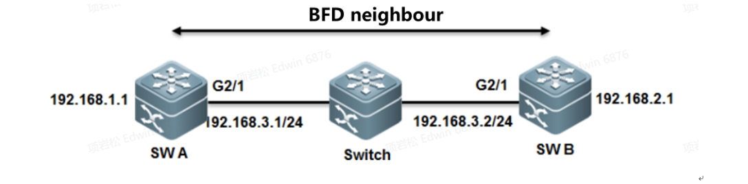

Policy-based Routing and BFD linkage example
a) Requirement
The Layer 3 switches SWA and SWB are interconnected via the Layer 2 switch. Policy routes are configured on the devices to establish forwarding paths, while allowing policy routes to be associated with BFD applications on the interfaces of both sides. In the event of a link failure between SWB and the Layer 2 switch, BFD can quickly detect and notify the policy route, triggering the system to delete the policy route, thus avoiding routing errors.
b) Network Topology
c) Configuration
Configurationon SWA:
1)Configureip and BFD session parameters on the interface g2/1
SWA>en
SWA# configure terminal
SWA(config)# interface GigabitEthernet2/1
SWA(config-if)# no switchport
SWA(config-if)# ip address 192.168.3.1255.255.255.0
SWA(config-if)# bfd interval 500 min_rx 500multiplier 5
------>Configure the BFD time parameter, this command alsoenables the BFD function of the interface, so it must be configured; 500/500/3is the recommended configuration here, sending a probe message at 500msinterval, and declaring the link failure if no response is received for 3consecutive times.
SWA(config-if)# no bfd echo
2) Configure ip on the interface ge1/1
SWA(config-if)# exit
SWA(config)# interface GigabitEthernet1/1
SWA(config)# ip address 192.168.1.1 255.255.255.0
3) Configure policy-based route and associate BFDto detect the neighbor 192.168.3.2
SWA(config)# ip access-list extended 100
SWA(config-ext-nacl)# permit ip any 192.168.2.00.0.0.255
SWA(config-ext-nacl)# deny ip any any
SWA(config-ext-nacl)# exit
SWA(config)# route-map Example1 permit 10
SWA(config-route-map)# match ip address 100
SWA(config-route-map)# set ip precedence priority
SWA(config-route-map)#set ip next-hopverify-availability 192.168.3.2 bfd GigabitEthernet 0/1 192.168.3.2
SWA(config)# end
SWA#wr
1) Configure ip and BFD session parameters on theinterface g2/1
SWB>en
SWB#configure terminal
SWB(config)# interface GigabitEthernet 2/1
SWB(config-if)# no switchport
SWB(config-if)# ip address 192.168.3.2255.255.255.0
SWB(config-if)# bfd interval 500 min_rx 500multiplier 5
SWB(config-if)# no bfd echo
SWB(config-if)# exit
SWB(config)# interface GigabitEthernet1/1
SWB(config)# ip address 192.168.2.1 255.255.255.0
3) Configure policy-based route and associate BFDto detect the neighbor 192.168.3.1
SWB(config)# ip access-list extended 100
SWB(config-ext-nacl)# permit ip any 192.168.1.00.0.0.255
SWB(config-ext-nacl)# deny ip any any
SWB(config-ext-nacl)# exit
SWB(config)# route-map Example1 permit 10
SWB(config-route-map)# match ip address 100
SWB(config-route-map)# set ip precedence priority
SWB(config-route-map)#set ip next-hopverify-availability 192.168.3.1 bfd GigabitEthernet 2/1 192.168.3.1
SWB(config)# end
SWB#wr
