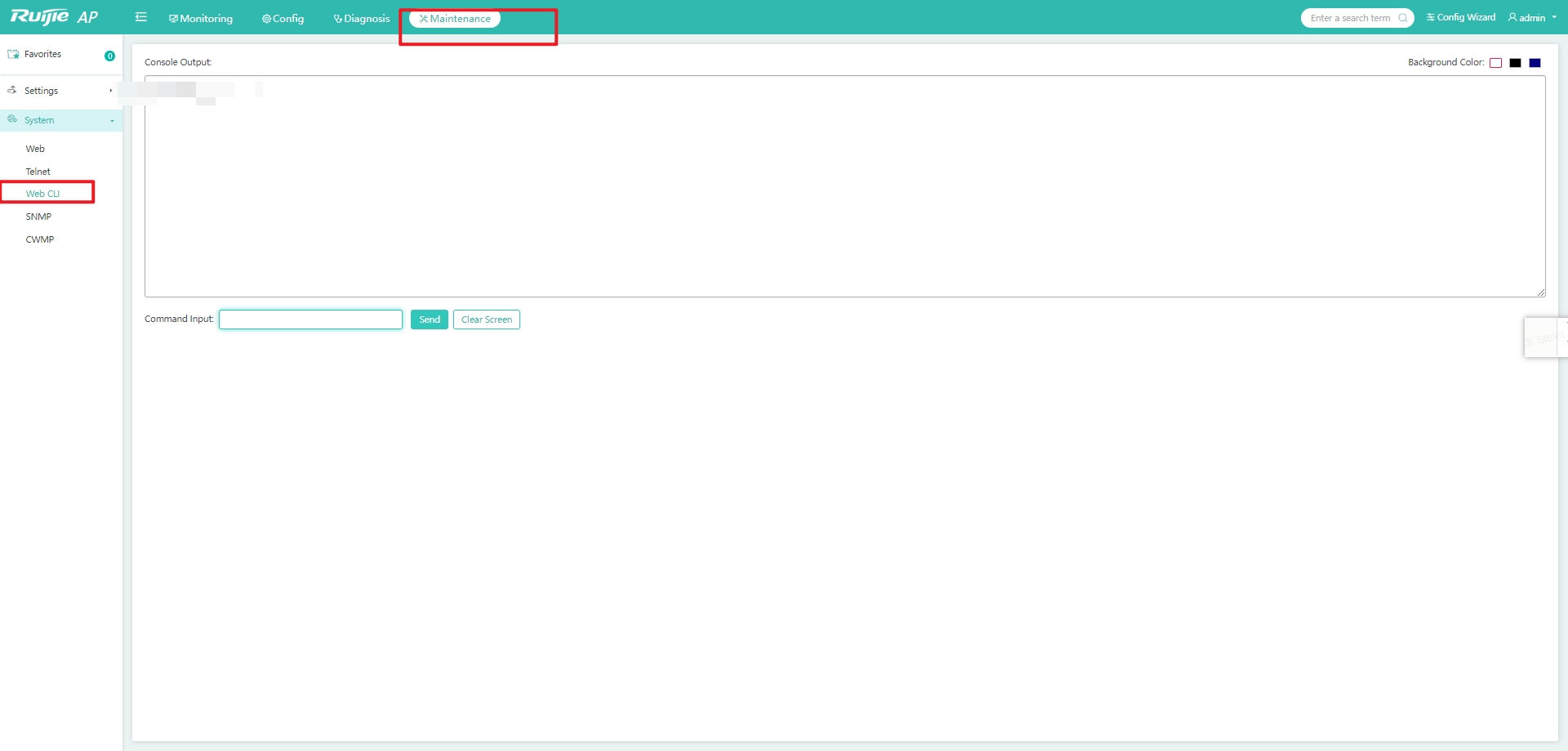

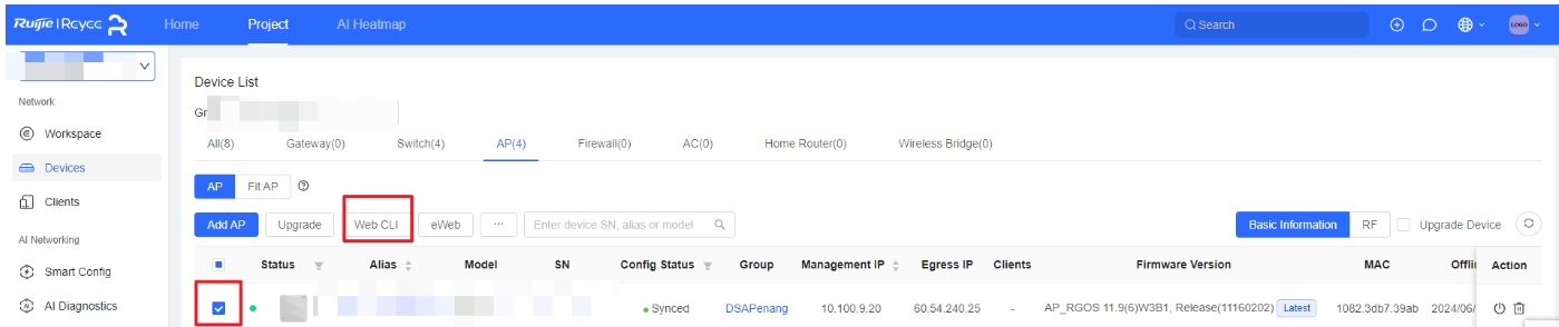

Can I run those cmd using web terminal?
0 2024-6-26 14:22:00 View all replies
nbctcp bun replied at 2024-6-25 08:37
AFAIK RAP didn't have console
Hi sir,
Sorry, RAP cannot support CLI function and cannot support configure TTL.
