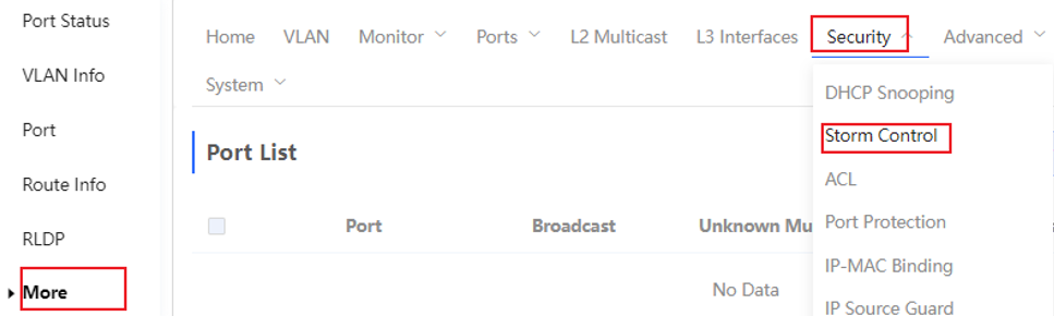

1. Login to the Eweb of Reyee NBS series switch, enter to this page:
[More] > [Security]> [Storm Control]

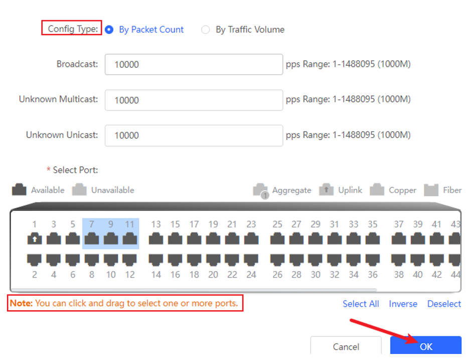

2. Click Batch Edit. In the displayed dialog box, select configuration types and ports, enter the rate limits of broadcast, unknown multicast, and unknown unicast, and click OK.
