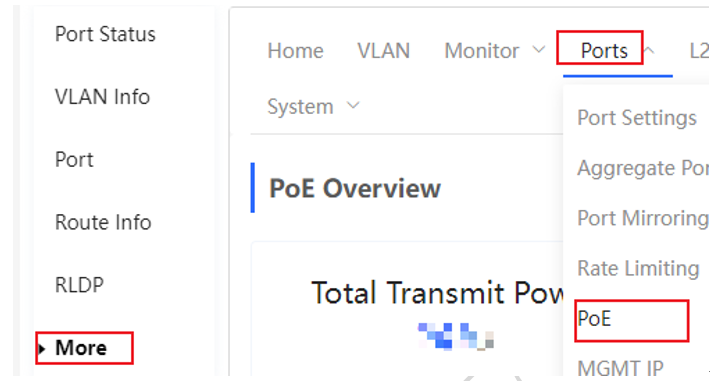

When you login to the Eweb of Reyee NBS series switches, you can check the PoE status by following these steps:
1.Enter this page: [More] > [Ports] >[PoE]

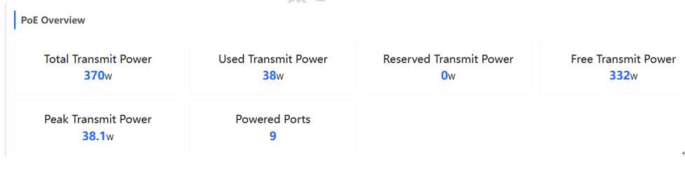

2.You can check the global PoE information on the PoE Overview part.

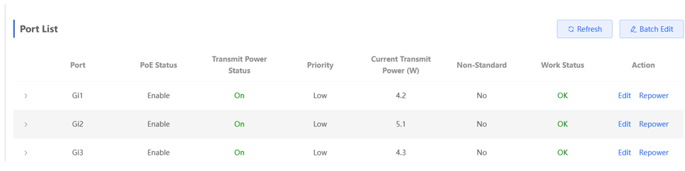

3.Scroll down, you can check the Port PoEInformation on the Port List part .

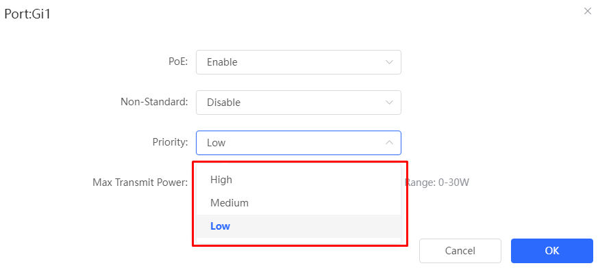

Hello Sophia,
what about difference of Priority? and when we should change it?
0 2023-5-25 16:47:07 View all replies
LORDBYAKU replied at 2023-5-25 16:31
Hello Sophia,
Dear sir,
The power supply priority of the port is divided into three levels: High, Medium, and Low
In auto and energy-saving modes, ports with high priorities are powered first. When the system power of the PoE
device is insufficient, ports with low priorities are powered off first.
Ports with the same priority are sorted by the port number. A smaller port number indicates a higher prior.
