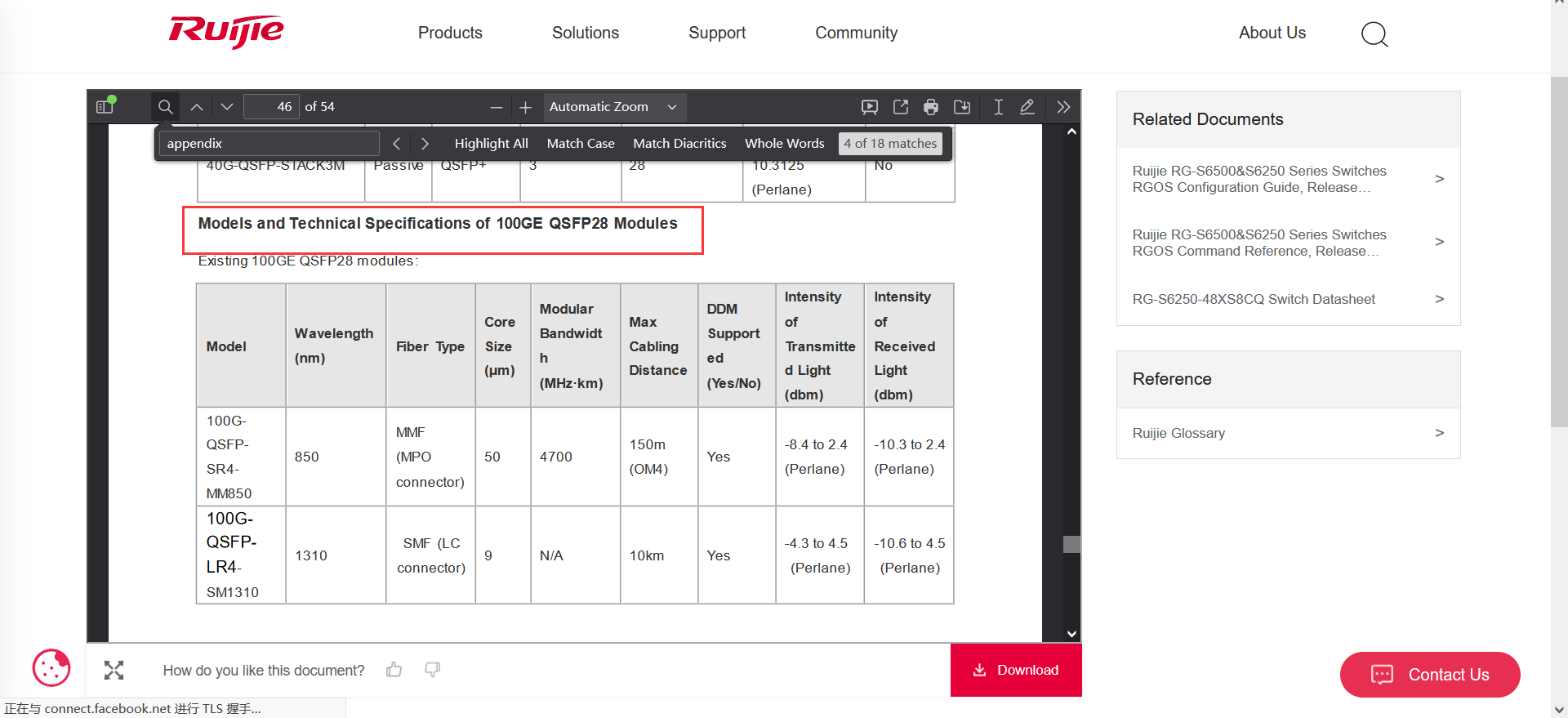

Does S6250 support VSU on 100G ports with DAC cable?
Does Ruijie hava such DAC cable? What is the p/n if any?
Can S6250 use 40G DAC cable for stacking on 100G ports?
RG-S6250-48XS8CQ
Switch Network Setting Product Manual Others
0 2023-5-26 20:30:08 View all replies
Yes, RG-S6250-48XS8CQ can support VSU on both 100G and 10G ports. You can refer to this link for 100G SFP+ modules on page 46: https://www.ruijienetworks.com/resources/preview/76697
--->Yes, the 100G QSFP28 port can also support both 40GE mode.
