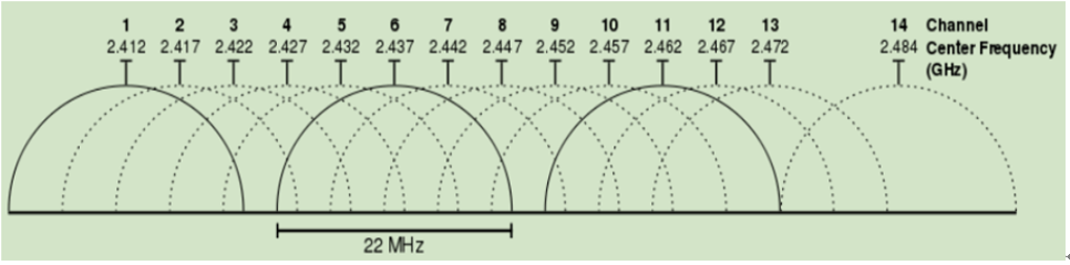

(1) Channel

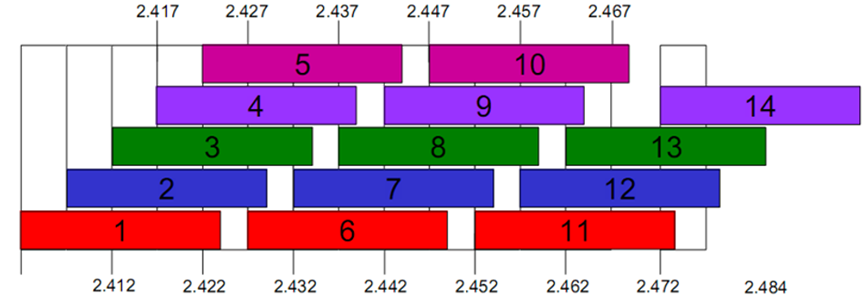

The total width of the band is 0.0835 GHz (83.5MHz). The band is divided into 14 channels (13 of which are used in China). The width of each channel is 22 MHz of which 20 MHz is valid width and the rest 2MHz is used as buffer. In this case, adjacent channels overlap each other. As shown in the following figure, each semicircle indicates a channel. When using the 2.4 GHz band to transmit data, a terminal can choose a channel for transmission.
1) 2.4 GHz channels
In China, the numbers of the available channels range from 1 to 13. Of the channels, there are three groups of channels that do not overlap each other: channel 1/6/11, channel 2/7/12, and channel 3/8/13.

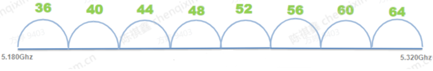

2) 5 GHz channels
•The 5.2 GHz band has eight non-overlapping channels whose numbers are 36, 40, 44,48, 52, 56, 60, and 64.
•  The 5.8 GHz band has five non-overlapping channels whose numbers are 149, 153, 157,161, and 165.
